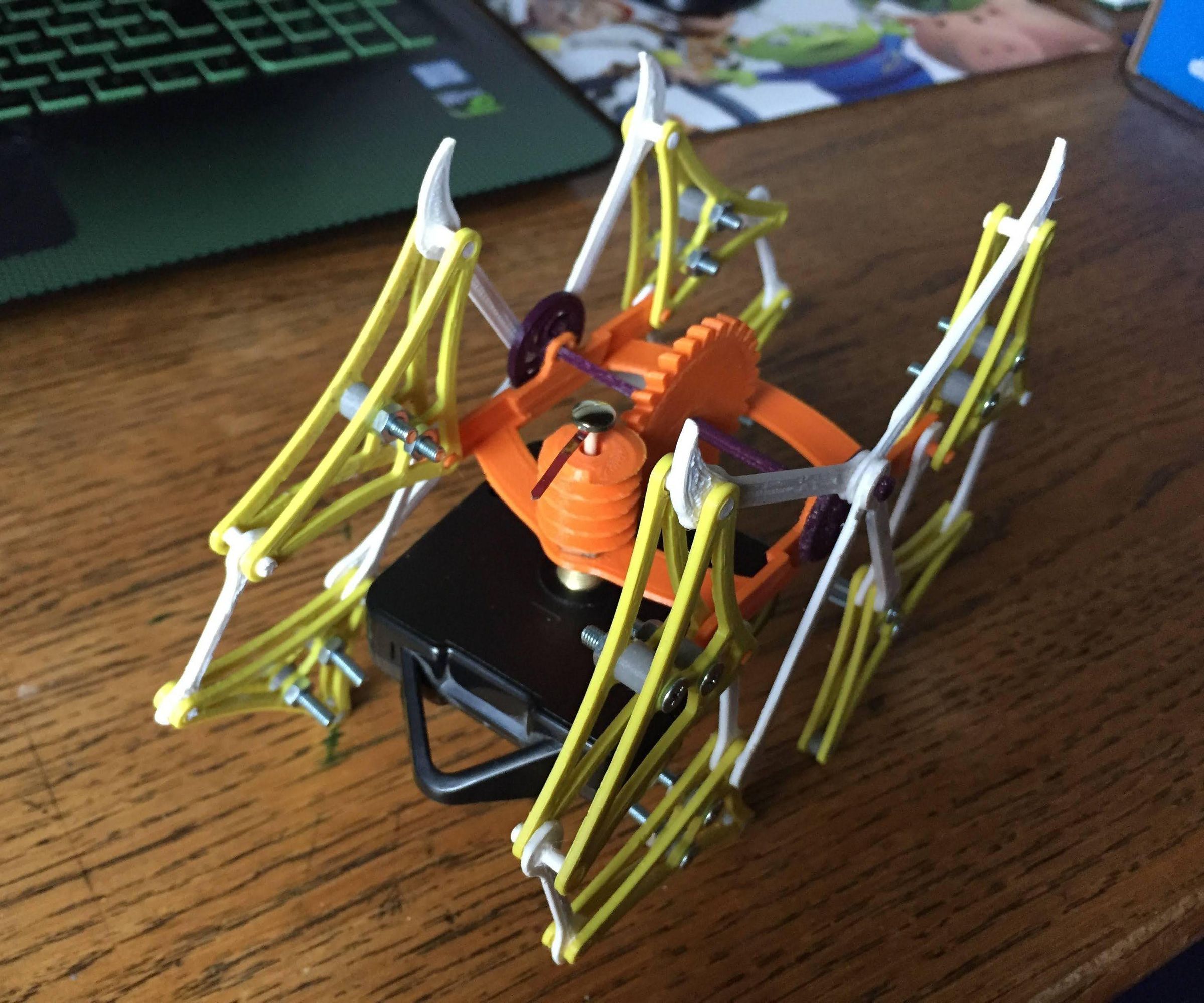

Step 4: Getting the Axle
The original robot uses a simple DC motor with a reduction powered by a single AA battery to move its legs. The legs have their own gear mechanisms (which I didn't redo, I only made a new body driving the old legs) and the center gear is connected onto a hexagonal axle, I didn't want to make those gears new so I just used the original axle. Doing so meant that I first had to harvest it from the original motor. I pulled the axle out of the case with pliers and then cut it in half because you are now driving the left and right legs separately.
Note: while cutting the axle, try to make the cut as thin as possible because the new body adds about 20mm to the width so you might end up short
Step 5: Assembling the Drivetrain
With the other gears and to axle halves you can finish the drivetrain. Begin by placing the smaller gear in the space available and make sure that it's centered so you don't have any problems when installing the axle.
Once lined up push the axle through the gear and make sure that it's in all the way.
Do this on the other side and you have a completed drivetrain.

If, to this point, everything went smoothly you now have a finished robot, at least the part we are re-making. The finished spider now only needs its legs which, if you remember from step 4, are unchanged from the original kit. They only need to be attached.
After slotting onto their designated pins and axle, the legs only need to be secured with the, so dubbed, "sway bar". It just clicks into the slots where the original "sway bar" once lived. On photo four you can see the length comparison of the original(left) and new(right) sway bars.
