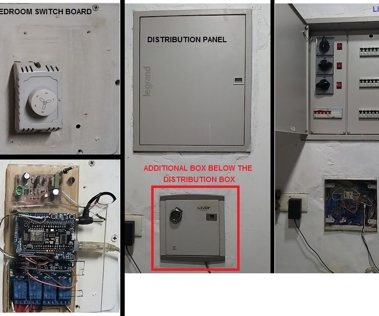

Having made an IR remote controlled switch for my house, I wanted to try the Bluetooth this time. So although I started to make a blue tooth controlled switch, I ended up throwing in a LCD display to see what was happening and finally added a distance sensor to turn on one light when a hand was waved in front of it.
I threw in a clock module so that the LCD display would not look blank when it had nothing to display.

Having made a shield in my previous project to operate the 16x2 LCD display with three wires, I ran into problems while trying to use the Lidquidcrystal595.h library originally written by Rowan Simms. When I Googled, I found there were others on the Arduino forum who had run into similar problems with code and hardware that had previously been proven.
Having made a shield, I was too lazy to make another one to work around the problem (especially after I established that my LCD display was in perfect working condition). The problem I faced is best summarized at https://forum.arduino.cc/index.php?topic=367676.0....
So for this project in order to display multiple characters, I have had to write a few lines of code to strip the string one character at a time and write it at different positions on the display.
