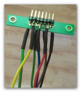

Step 2: Making a Harness for the Cybot Connections
The cybot motors are controlled via an H-Bridge board which was desined to link up with other boards in the robot, but to keep interest in the build the publishers of the magazine supplied a jumper board which linked the power to the forward motion pins for both motors and let the base drive forwards.
I too this and removed the track between these pins. The I stripped and tinned 7 wires (each a different color for easy identification) and soldered a single wird to each of the seven pins
I later found that I had managed to link some of these pins so shorting connections an preventing proper operation (I will go back and fix this later)
As part of the harness I also used heat shrink in an attempt to stop potential shorting (that really worked didnt it)

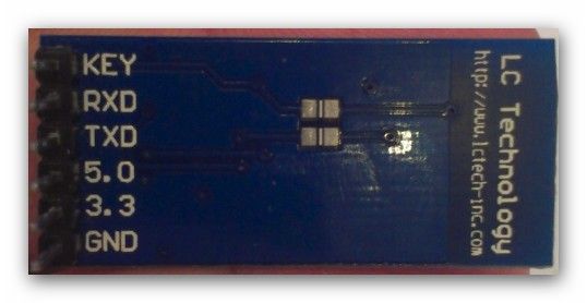

Step 3: Bluetooth Cable
Before I stated connecting up the components to the cybot I used a breadboard to test out the various parts trying to reduce wasted time later. once this was done I had to make up a Dupont cable conection (see pictures) as I only had four and two pin connectors I made up one of each and later used a drop of hot glue to hold them together.
The only pins needed for this project are the Ground/RX/TX and 5 volt, but I connected a cable for each for future use if needed.

Bluetooth Connections to the Arduino
Bluetooth pinArduino Pin
GroundToGround
5 voltTo~5V
RX To~11
TXTo~10
Power is supplied to the H-Bridge via the Cybot powerpack on the under side of the base, while the Bluetooth Circuit is powered by a separate battery pack with connections to Ground and the Vin pins of the Arduino

Working as above I found that the cable harness I had made to link the Cybot H bridge to the Arduino was shorting out which resulted in temperamental operation.
So while I think its a good idea to use the harness and have left its creation in as part of the instructable - you will notice that the fully operational video has direct connections using jumper wires

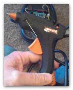

Step 7: Tidy Up the Wires
Once it was all working it as time to tidy up the wires,
To do this I simply re-routed some of the cables and attached the Bluetooth switch to the under side using hot glue.
I also needed to make a mount for the Bluetooth module - for this I use 4 Dupont connector cases and hot glued then together the attached the Bluetooth cable and the mount to the base using hot glue.see pictures
