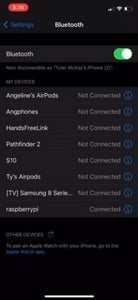

Step 5: Pair Your Device With the Pi
The program you'll be running to play entrance music assumes that any device you want to play entrance music for has already paired with the pi before. So you'll need to connect those devices to the Pi at least one time, so the Pi understands what the device is. To do this I marked the Pi as Discoverable in the menu bar of the UI, then on my iPhone I connected to the raspberry pi, and lastly I confirmed in the UI of the Pi to connect to the phone. Once successfully connected, I disconnect the device because all we needed to do was pair.

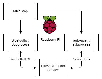

Step 6: Understand the Program Architecture
Before diving into the code it will help to get an understanding of how the program is supposed to work. The idea is that a main loop will constantly be running on the raspberry pi in the background. It will have a list of mac addresses pointed to an audio file to play for that mac address, and it will constantly be going through that list of mac addresses and trying to connect to it via bluetooth. When it fails to connect to a mac address, it will go to the next mac address and keep trying repeating the list over and over again until a connection is successful. The idea is that the connection will not be successful unless a device is close enough to the pi. After a successful connection, the pi will play the audio file associated with that mac address and end the program.
The main loop of the program in EntranceMusic.py is communicating with the bluetoothctl shell and the auto-agent script through subprocesses. It spawns a subprocess for each one to communicate with the bluetooth interface. The bluetoothctl shell is a well known interface to perform bluetooth actions from the command line, while the auto-agent file is a script I made from copying snippets of code from forums. I chose not to change the majority of the file to preserve the work of the original author, and also to give you an idea of other commands you are able to run with bluetooth (we really only care about connections, but you can do much more). Both of these files communicate with the Bluez service.
The auto-agent file creates a python object that represents a system bus and this is what allows us to communicate with the Bluez service. You can think of this object as a way to communicate between services (versus communicating between applications). Once the object is constructed there are a few methods that need overriding to successfully interface with the system bus. If this is confusing to you, I would recommend skipping over this as the most important part in this file is the hooks that are called when a pair request is successful pair_reply or a pair request fails pair_error. These methods output messages to stdout which the main loop is watching, and based on those messages, the main loop will understand if a connection to the mac address worked or not. If it works, the main loop plays music, otherwise, it cycles through the next mac address and spawns another auto-agent subprocess to attempt a pairing.
