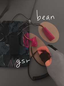

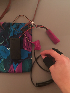

Enclosure for LightBlue Bean and sensor
I decided to put the battery holder and LightBlue Bean inside a small bag that I will have around my neck. This way I'm able to easily move around with the gsr sensor while setting up the installation. I covered the bean and the sensor with electric tape.
