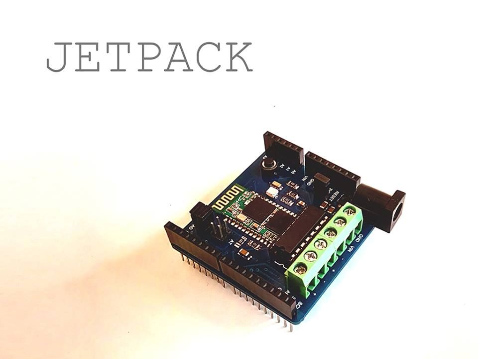

Hey, I want to show an easy way to build a basic game controller with joystick. The Jetpack transmits the data from joystick serially via Bluetooth. You can play any game on your PC with this, you just need to change the required key as shown in the read me file. We did this as part of our kickstarter called Jetpack a wireless programing Bluetooth shield+motor driver shield for Arduino. You can use your own substitutes for this.
Got 750% funded on Kickstarter! We are amazed by this response and so jet pack is now available for preorder on http://www.jetpackshield.com/

Step 1: Make the Connections As Shown
Connect the Joystick to Jetpack and mount it on an Arduino as shown in the picture. Connect the power supply.
PIN DESCRIPTION
