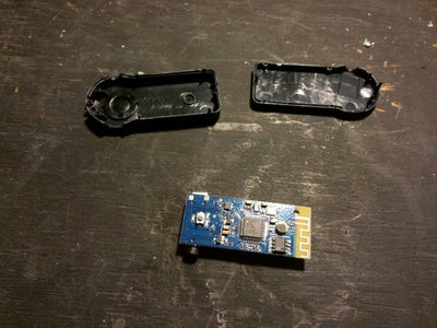

So, I bought the cheapest bluetooth hands free I could found (the first one came broken, that's why there are some holes and pieces of plastic missing inside the headphones, from the previous attempt) and, besides it, every tool and material I allready have it around. Some piezes are not that common, but they come from dispossal computers, and broken cables that any friend could have.

Then, I split the plastic over the bluetooth chip. No more to do here

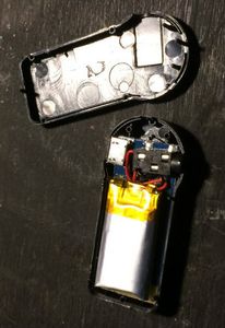

Also, in my specific case, the space between the magnet and the back of the headphone case, was so small, that i need to put the batery next to the bluetooh.
After everything is align, use som epoxy clay to fix the parts inside the case.

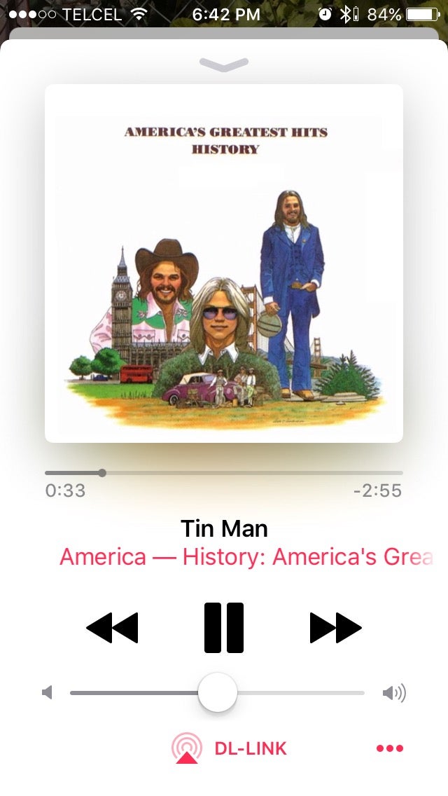

The bluetooth battery last around 6/7 hours of continuous playing.
Press the On/Off Switch 10 seconds to enter "discovery mode" and connect your phone to "DL-Link"
Press it around 3-5 seconds to turn it on or off.
