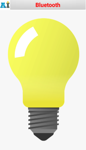

Step 4: Downloading the App
I have made the app in "MIT App Inventor". You don't have to make the app because I have provided the .apk file for the app. The app is called "Bluetooth_LED.apk." I also have should in more detail how to make the app in the video above.

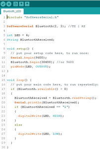

Step 5: Programming
Open the program file and then verify the sketch. If the sketch is free of errors you can go on by checking if you have selected the correct board and port. After that, you can upload the sketch to the Arduino.

Step 6: Testing the Project
Open the app you had downloaded in the previous step. Make sure the Arduino board is plugged into a power source. Now click on "Bluetooth." The button will be red when there is no device connected. Now select your Bluetooth module. Once you have connected it to a device, the Bluetooth should turn green on the app and the LED on the HC-05 should start blinking slowly. Now you can click on the light bulb to turn On and Off the LED connected to the Arduino board.
