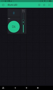

Step 5: Building the App
For the complete directions on how to make the app, you can watch my video.
Name >> Connection >> Value >> Reading Rate
Bluetooth
Button >> D4 >> 0 - 1 >> Switch
Vertical Slider >> D5 >> 0 - 255 >> Slide on Release; Off

To test if the project is working properly, plug the Arduino into a power source. The onboard LED should turn on. After that, open the Blynk application and run your project. Click on the Bluetooth icon and then connect it to your Bluetooth Module. Once the Bluetooth has connected, the built-in LED on the HC-05 should blink slowly. Now on the app, if you press the button, the red LED should turn on. And as you slide the slider up, the blue LED should get brighter.
