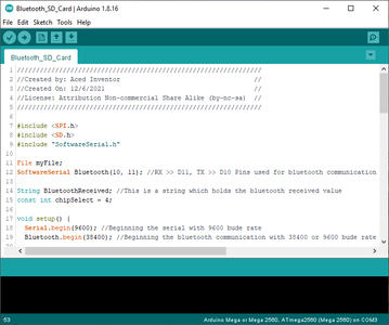

Step 5: Programming
Open the program on Arduino IDE. Once it is open, compile the sketch to see if it is clear of error and upload it. You don't have to download any external libraries for this project as they come pre-installed with Arduino IDE. Once you have uploaded the code open the App and connect to the HC-05 Bluetooth Module.

Step 6: Testing the Project
Now that you have connected your Phone to the HC-05 Bluetooth module. Whatever you type on the app and press send will be saved on the micro SD mard. The box on the top of the app is where you type what you want to send over to the SD card and the box on the bottom is where you can see all the data on the SD card
