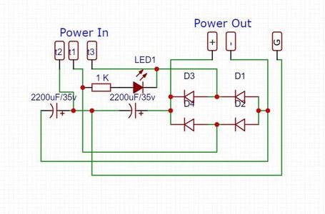

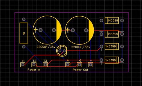

Step 3: Schematics and PCB Design
The final schematics and PCB design can be seen above.

Now we need to connect power supply and audio input cable and sound speaker with the amplifier circuit. To operate this amplifier circuit, we need dual power supply circuit.
Dual Power Supply Will Provide Us DC “+20v”,” +40v” And “G” Voltage.
Now, We Connect Power Supply With The Amplifier Circuit. Connect “DC +40v” With 7no Leg Of Sound IC, “DC +20” With 5no Leg Of Sound IC & “G” Voltage With 8no Leg Of Sound IC.
