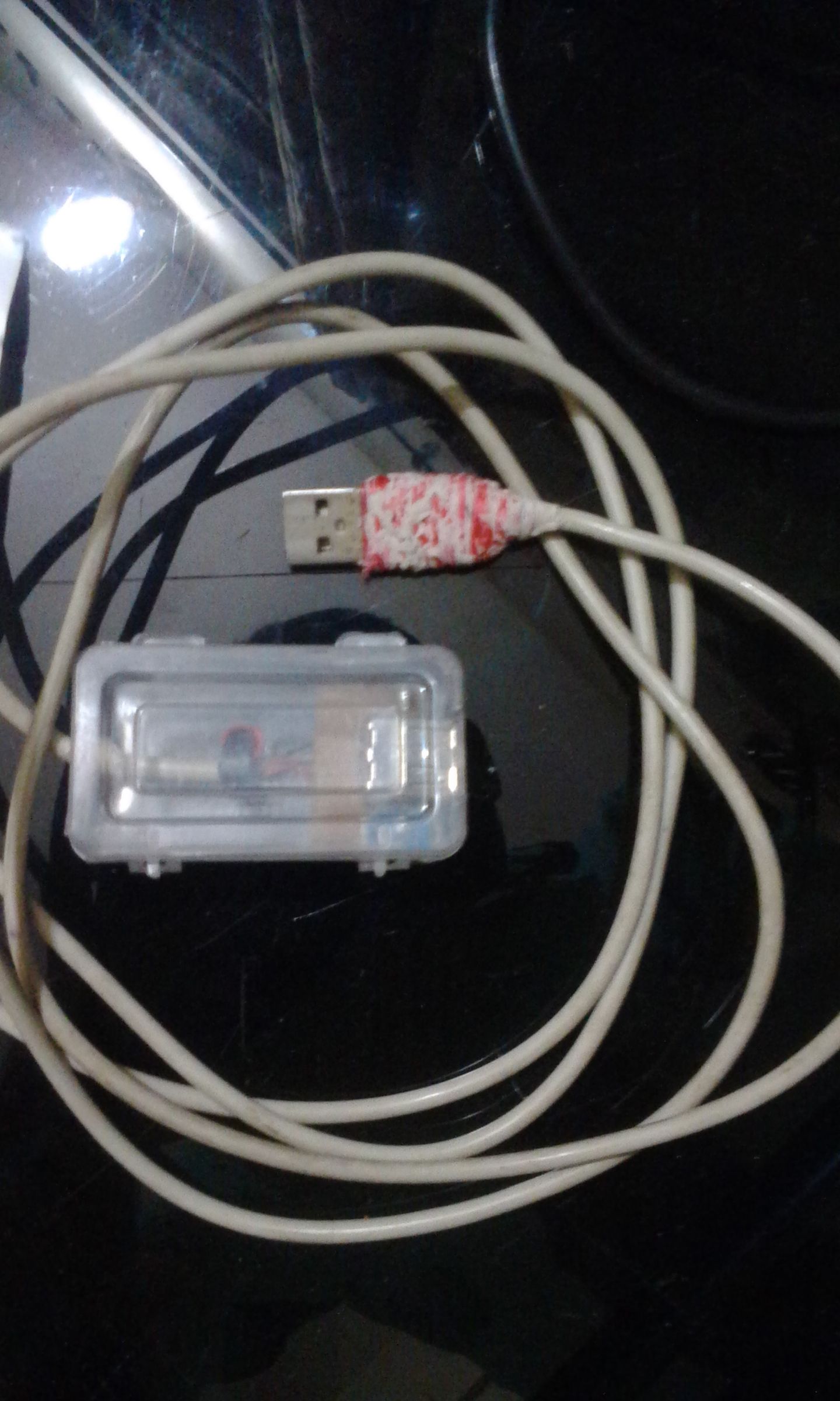

Introduction: Bluetooth Speaker From Scrap
super easy Bluetooth speaker from scrap all packed in a maths geometry instrument box let's begin
Step 1: Parts Essential
bluetooth +amplifier on board module(remove from a scrap wireless speaker)
.mobile battery 3.7v
.two 0.5w speaker
.wires
.a geometry instrument box
.soldering,sharp blade
.two 0.5w speaker
.wires
Step 2: Make Vents and Slots on Box
make vents/opening on the top of box for speakers.
place the speakers inside the box glue it.
make cuts on side of box for USB and charging slot
Step 3: Place All Parts and Connection Inside Box
connect the speaker in parallel to the spkr terminal on board.
then connect battery to the BAT point on module
screw the module board inside box,its ready to boom the room
