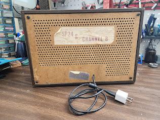

I was at a thrift store and found an old speaker that was a wireless speaker years ago. I thought it would be fun to resurrect it into a modern wireless speaker. I had a lot of electronics supplies and Bluetooth modules from other projects, so I thought this would be a quick and dirty project.
I've taken apart old boomboxes and other devices to mount BT modules in them, but never documented it, so I thought I'd do it here.

Step 1: Find Your New Speaker Enclosure
The Hunt Begins!
Head to your local thrift store, garage sale, or dig through your basement. Look for old speakers that:
  1. Have a solid, intact enclosure (no cracks or major damage)
  2. Look cool or vintage (this is your chance to pick something with character!)
  3. Are reasonably sized (remember, you'll need to fit electronics inside)
I found an old wireless speaker from the early 2000s that caught my eye. It had that retro look I wanted, and the price was right!
Why this works: We're essentially using the enclosure as a "shell" for modern Bluetooth electronics. The old wireless technology is outdated, but the box itself is still perfectly good for holding a speaker and amplifier.
Pro Tip: Don't worry too much about whether the electronics inside still work. We're going to replace them anyway!

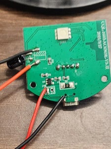

Step 3: Prepare Your Donor Bluetooth Amplifier
Scavenging for Parts

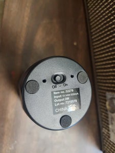

We're also going to need a BT amplifier board. You can buy standalone BT amps from a lot of places for $10 or less, but most of them are stereo and I needed a mono amplifier.
Over the years I've hoarded a number of small BT speakers I've gotten as freebies. Since they usually only have one speaker, I decided I'd use one of these for a donor amplifier.
Why use a donor speaker?
  1. Most standalone BT amp boards are stereo (two channels), but we only need mono (one channel) for a single speaker
  2. Those freebie Bluetooth speakers you get at events usually have exactly what we need
  3. They're already assembled and tested
  4. The amplifier is matched to work with small speakers
Disassembling Your Donor Speaker:
Disassemble your donor speaker and you'll likely find 3 major components:
  1. The speaker (we won't need this)
  2. The battery (we won't need this either)
  3. The PCB (circuit board) - THIS is what we want!
You will not need the speaker or the battery, so they can be removed from the board.
Important - Before You Remove Anything:
Take pictures or document where the wires to the battery and speaker go and their polarity. You'll need to know that in the future.
  1. Take clear photos of where wires connect to the battery
  2. Note the polarity: which wire goes to + and which to -
  3. Take photos of where the speaker wires connect
  4. Document any color coding
For Now: Remove the speaker now, but for simplicity of pretest, you can leave the battery attached as long as it's charged.
Pro Tip: Label wires with masking tape as you disconnect them. Write things like "Battery +" or "Speaker -" on the tape.

Using red and black jumper wire for positive and negative, solder a red wire from the + speaker output on the amplifier board to the + terminal of the speaker. Do the same with the - terminals using black wire.
Why red and black? This is standard electronics convention. Red = positive (+), Black = negative (-) or ground. Following this makes troubleshooting easier.

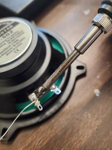

Step 5: Install Replacement Speaker (If Needed)
When the Original Doesn't Make the Cut
If your original speaker failed the sound test, here's how to install a new one.
Choosing a Replacement:
Important Specifications:
  1. Size: Measure the diameter of your original speaker (common sizes: 2", 3", 4", 5")
  2. Impedance: Usually 4Ω or 8Ω (check what your donor amp board expects - usually marked on the PCB)
  3. Power handling: 3-10 watts is typical for these projects
  4. Type: Get a "full-range" speaker, not just a woofer or tweeter
Where to buy: Amazon, Parts Express, or any electronics supplier.
What If It Doesn't Fit?
If the speaker you order doesn't fit, you are able to print an adapter ring to adjust the fit.
Speakers come in standard sizes, but mounting holes and depths vary. You have options:
Option 1 - 3D Print an Adapter Ring: If you have access to a 3D printer, you can design and print a simple adapter ring. This is basically a plastic spacer that adapts your new speaker's mounting holes to the old speaker's location.
Option 2 - Improvise:
  1. Use hot glue to secure the speaker (works but isn't ideal)
  2. Cut a cardboard or thin wood ring to adapt the fit
  3. Use foam weatherstripping to fill gaps
Installation:
  1. Remove the old speaker (if you haven't already)
  2. Test fit the new speaker - does it sit properly?
  3. Connect the wires (remember: red to +, black to -)
  4. Secure the speaker with screws, adapter ring, or your chosen mounting method
  5. Test again to make sure everything still works and sounds good
Install speaker into the enclosure.

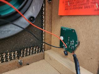

Step 7: Final Assembly and Mounting
Putting It All Together
Now that everything works, it's time to make it permanent and pretty.
Mounting the PCB:
Mount PCB inside of enclosure with double stick tape.
Using Double-Sided Tape:
  1. Clean the mounting surface inside the enclosure with rubbing alcohol
  2. Apply double-sided mounting tape to the back of the PCB
  3. Use foam mounting tape if possible (it dampens vibration)
  4. Regular double-sided tape works too
  5. Position the board carefully - think about:
  6. Will the USB cable reach the exit point?
  7. Is it clear of the speaker cone's movement?
  8. Can you still close the enclosure?
  9. Press firmly to secure
Alternative Mounting: Hot glue, screws with standoffs, or velcro strips all work. Choose what you're comfortable with.
Creating a Strain Relief:
Make a strain relief by tying a knot, or a zip tie where the cable exits the enclosure.
This is super important! A strain relief prevents the USB cable from getting yanked out or breaking at the solder joints.

  4. Plug in USB power
  5. Pair Bluetooth
  6. Play music
  7. Check volume level
  8. Replace all screws - reference those photos you took at the beginning!
