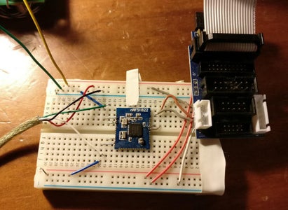

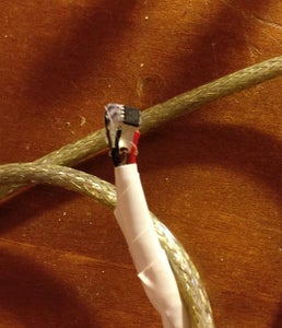

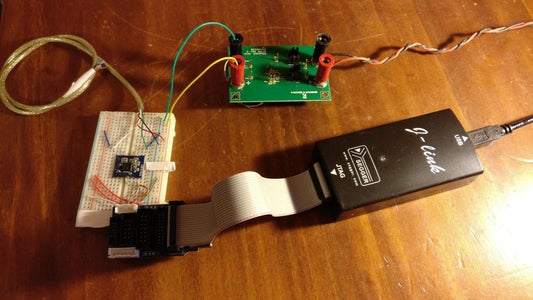

Step 1: Bill of Material
This is the list of the components I used to create the final BlueTempSense
- Waveshare Bluetooth Module (based on nRF51822 chipset)
- Adafruit MCP9808 temperature sensor (or equivalent)
- Segger J-Link debug probe
- A 3.3Vdc Power Supply (+cables)
- Some sort of 4 pin cable (to connect J-Link probe to Waveshare board)
- Soldering equipment (solder iron, solder wire, soldering skills, …)
- Misc electrical wires (desirable with different colors)
- A proto-board to assemble the system
Check here some pictures of my final setup

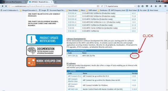

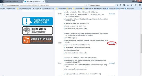

To download Nordic SDK Ver 10 you can do the following
- go to Nordic nRF51822 product’s webpage (http://www.nordicsemi.com/eng/Products/Bluetooth-low-energy/nRF51822)
Click “Download” Tab
Click on current SDK “version number” (check picture above)
Download SDK version 10 (check picture above)
Unzip in a folder without spaces in pathname

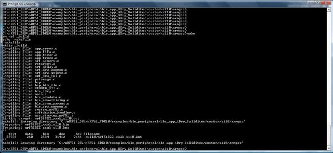

Now you can compile my example to test if your environment is correctly installed
Open a Shell window and change directory to:
C:\nRF51_DEV\nRF51_SDK10\examples\ble_peripheral\ble_app_iDry_Soliditec\custom\s110\armgcc
type "make" and press enter
If all is good you should get the window as shown in picture above
if that is not what you are getting:
most probably you are missing some critical path in your PATH variable

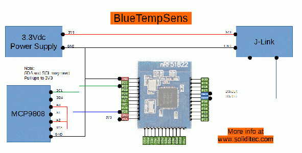

Step 4: Hardware Setup
Here’s a diagram of the connection you need to have in order to
loading and testing firmware and also read temperature on nRF51822 platform

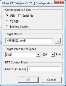

- Open J-Link RTT Viewer
Normally you can just accept default window (check image above)
J-Link RTT main window should be as picture above

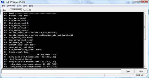

Terminal “0” shows debug messages
Here’s my debug session shrinked and with some explanations
BOOT ---------------------------------- !
timers_init done!
twi_init done!
ble_stack_init 1
ble_stack_init 2
ble_stack_init 3
ble_stack_init 4
ble_stack_init 5
in ble_stack_init before sd_ble_enable()
in ble_stack_init before softdevice_ble_evt_handler()
ble_stack_init done!
gap_param_init done!
services_init done!
advertising_init done!
conn_param_init done!
ble_advertising_start done!
timer_start done!
...................... Before Main Loop!

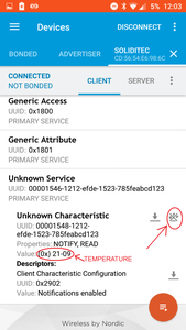

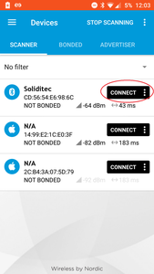

Step 7: Scan for Device and “Connect” Using NRFConnect Android Tool
Look for nRFConnect in Android Play store
Download and install
Start the "scanner"
Your device should show up as shown in picture above
Choose "Connect"
Your RTT debug messages should change and show you are now connected to your phone
Here's my RTT output

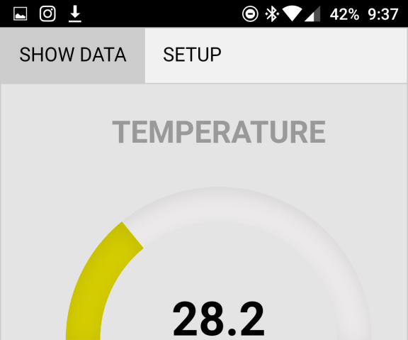

Step 8: Congratulations
Congratulations!!!!
Now your phone and your BLE device are connected and transmitting data!!!!

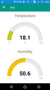

In my next lessons I’ll show you how to create an App to connect to your BLE device and show nicely temperature on cellphone screen
Like the screenshot here
