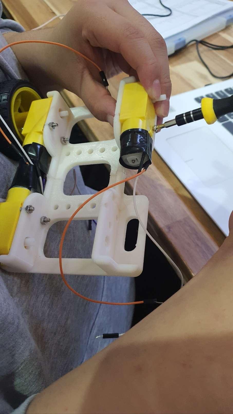

First off, we're going to use a 3D printer to manufacture the body of the car. Given that our 3D printer has a build volume of 12*12*12, we split the model into two halves, printed each one, and then joined them together using an adhesive.
With the car body ready, we mount four TT motors to it, marking the completion of our basic car assembly

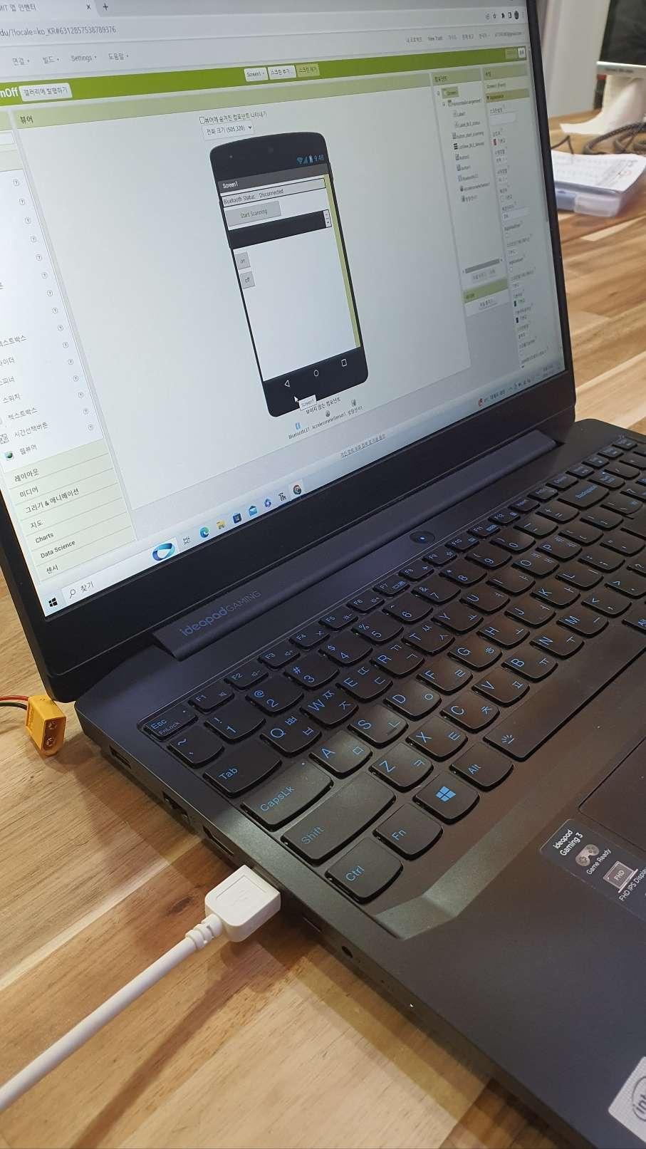

Step 4: Cdoe
By loading this program onto your Raspberry Pi Pico using a cable, you'll have everything you need to get your car moving.
Step 5: App Download
Download the app we've put together, pair it with your toy car via Bluetooth, hit the 'start' button, and then tilt your smartphone in the direction you'd like the car to move. Voila, your toy car is on the move!
