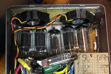

Cram amplifier circuit in the vacant space. The first and second stage needs one tube each, and output stage needs four tubes, so we need the place to set 6 tubes , but The sub-chassis for tubes has only four sockets and can be placed another. There is no other place to place one more tube. in such act of desperation, I employed subminiature tube 5676.

Step 8: Heat Exhaust System
Originally the receiver has four tubes, and these tubes and battery are neighboring each other. Now, all of four tubes has become power tube, and manganate battery replaced lithium battery.
Unless lithium battery prohibit heat, it would explode! ,So heat exhausting system is absolutely needed.
Make windows and set fan and partition.
