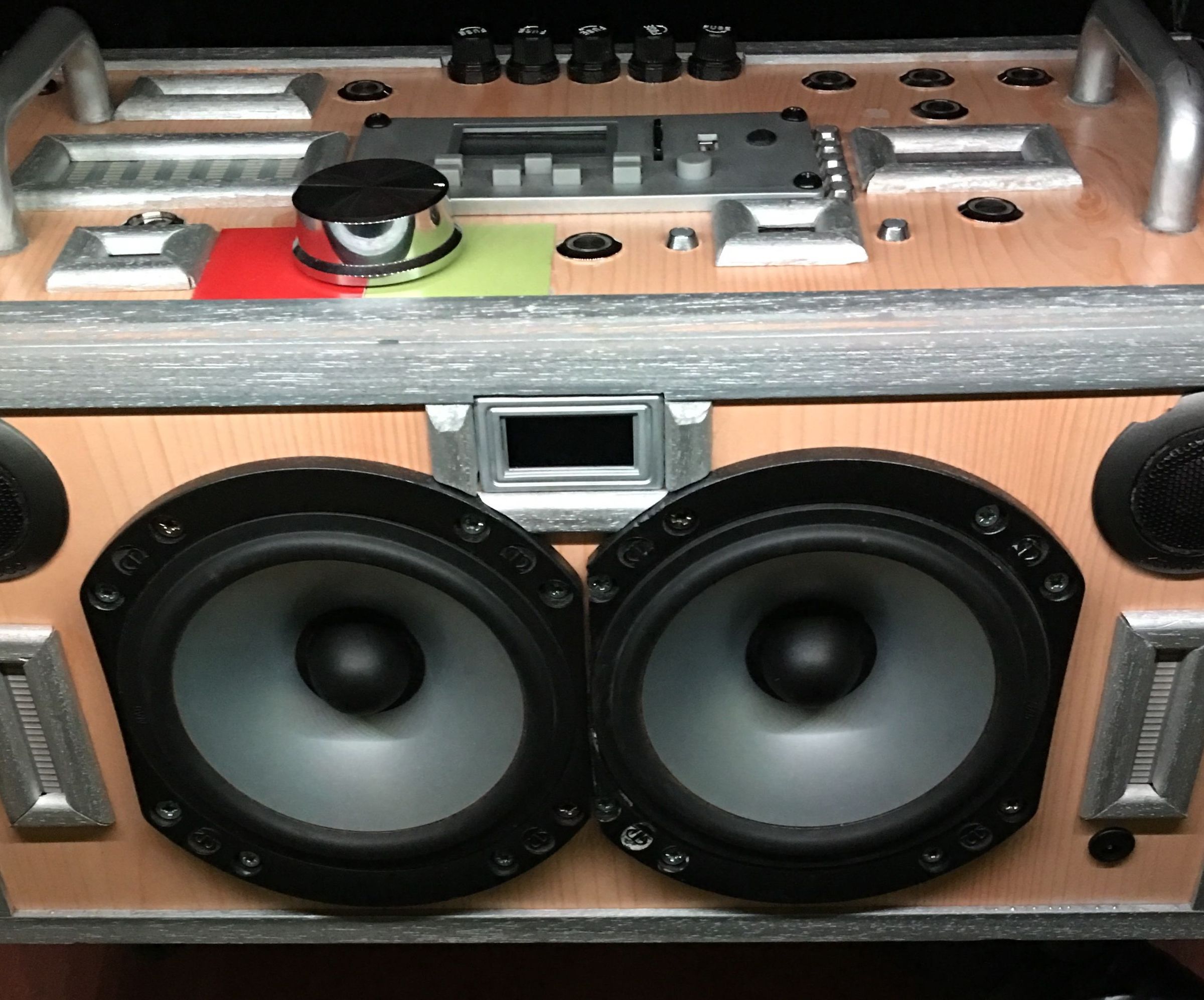

Since I had no need for the stereo or indeed the dock connector, I opened the whole thing up, removed all the circuit boards from the front panel, unplugged and threw away the dock connector, then set about half-sizing the front panel.
What I ended up with was a half-din sized plastic bezel for the control board to go back into.
I mounted that into the top of the box, then the rest of the circuit board was mounted at the bottom.
One channel from the amp runs the 6” speaker (taken from an old and tired home cinema subwoofer) and one 1” tweeter, another channel runs just a tweeter.
Strictly speaking it’s not really stereo (unless you’re only measuring high frequency) but it sounds extremely good as it is. I’d have preferred it to be proper mono, but then there is a tiny bit of imaging (and I do use that term loosely) because the tweeters are connected to different channels.
-I just avoid playing anything from the Beatles on it, or half the song is missing!!
There is a 7aH battery mounted inside, and a charger. As this was made from spare parts I didn’t have a figure8 socket - so I just cut a 1” hole in the rear of the unit and glued the charger directly to it, so the lead can plug straight into the existing socket on the transformer.
Copious amounts of glue ensured this was airtight. The weight of the charger itself would’ve eventually caused it to fall off the back if I’d not positioned it to be resting on the battery.
Battery charge level is monitored via the led battery display removed from the original “diy mobile soundstation” on my first instructable.
This display, and the ignition wire to the head unit are switched in via a 12v illuminated green switch towards the rear of the top panel.
The original head unit had connection for usb, so the cabling for this was extended and the socket mounted as a through-hole just above the half head unit, enabling playback from usb.
Bluetooth range is not fantastic, but it was only ever meant to be strong enough for use it a car. When connected though, it stays connected and sounds pretty decent.
I extended the original aerial socket to be mounted on the rear panel, just in case the mood ever takes me to listen to radio (admittedly, something I never do, but the option’s there)
Also on the rear panel is a bass port, this is the only thing I bought purposely for this unit, it was discontinued at maplin so I got it for 48p or something like that, and I’m glad I got it, mainly for ventilation as there’s a battery being charged in there, but also because if the port is covered up it doesn’t sound nearly as good.
