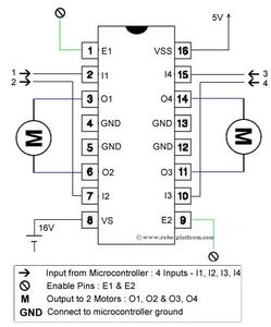

Step 4: L293D
connect the pins 4,5,12,13 of L293D to ground and connect O1, O2 to left motor, similarly O3,O4 to right motor,
i1-pin2 of induino
i2-pin4 of induino
i3-pin12 of induino
i4-pin11 of induino
i1-pin2 of induino
i2-pin4 of induino
i3-pin12 of induino
i4-pin11 of induino

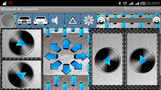

Download this app from play store..

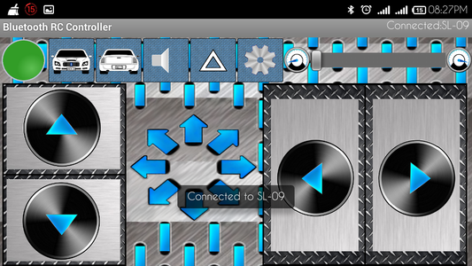

connect a 9v battery to induino.. the Bluetooth module will start to blink continuously.... now open the app in your mobile
1.At first a red light will blink at the left top of the app

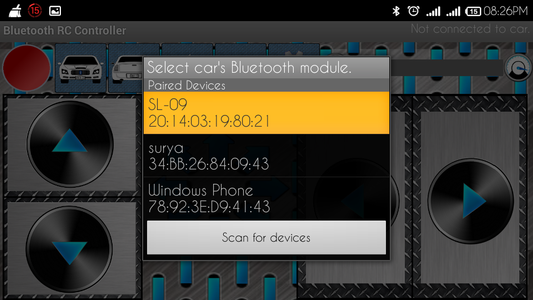

2. go to options and click connect
3. connect to the Bluetooth device.... default pin is 1234 or 0000
4. after connecting there will be green light in the left top corner of the app
that's it now you can enjoy your own Bluetooth RC robot
