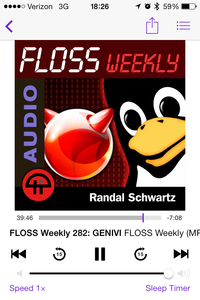

Next was the test. Apply power. Hear the Bluetooth linking sound on the car stereo (with the AUX input selected) the play a podcast. It worked! Took a 3.5mm patch cord and plugged it into the AUX jack and the Bluetooth audio was cut off. Plugged the other end of the patch cord into my phone and the podcast was back! Time to tidy things up.
