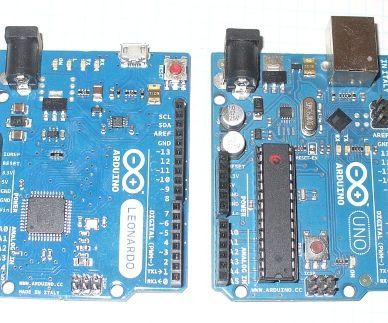

The arduino any model for the control of the leds, and possibly relays

to make this a standalone make your own arduino ( also to save money )
there is a wealth of info online
here's a link :
http://arduino.cc/en/Main/Standalone
you don't need the ftdi converter just program the chip pull it off the arduino and put it on the standalone board
