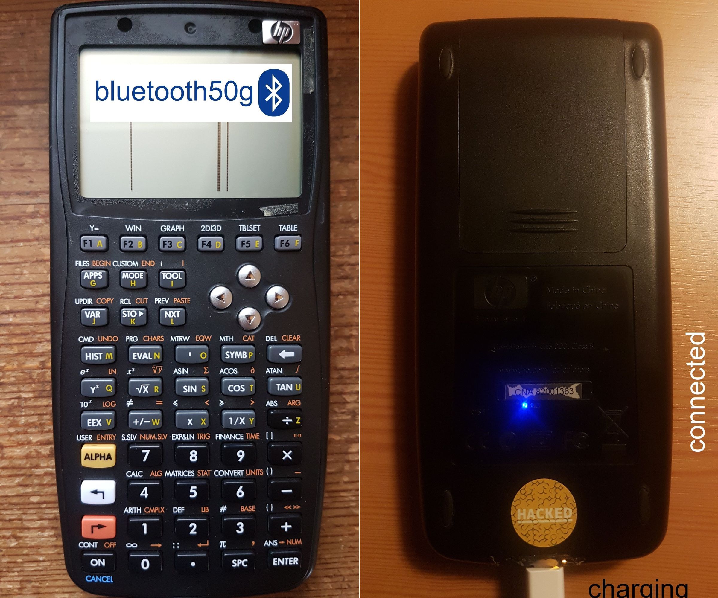

Reuse the keyboard and make it work as a bluetooth keyboard for your phone or/and PC.
It works great with EMU48 on Android phones and on Windows.

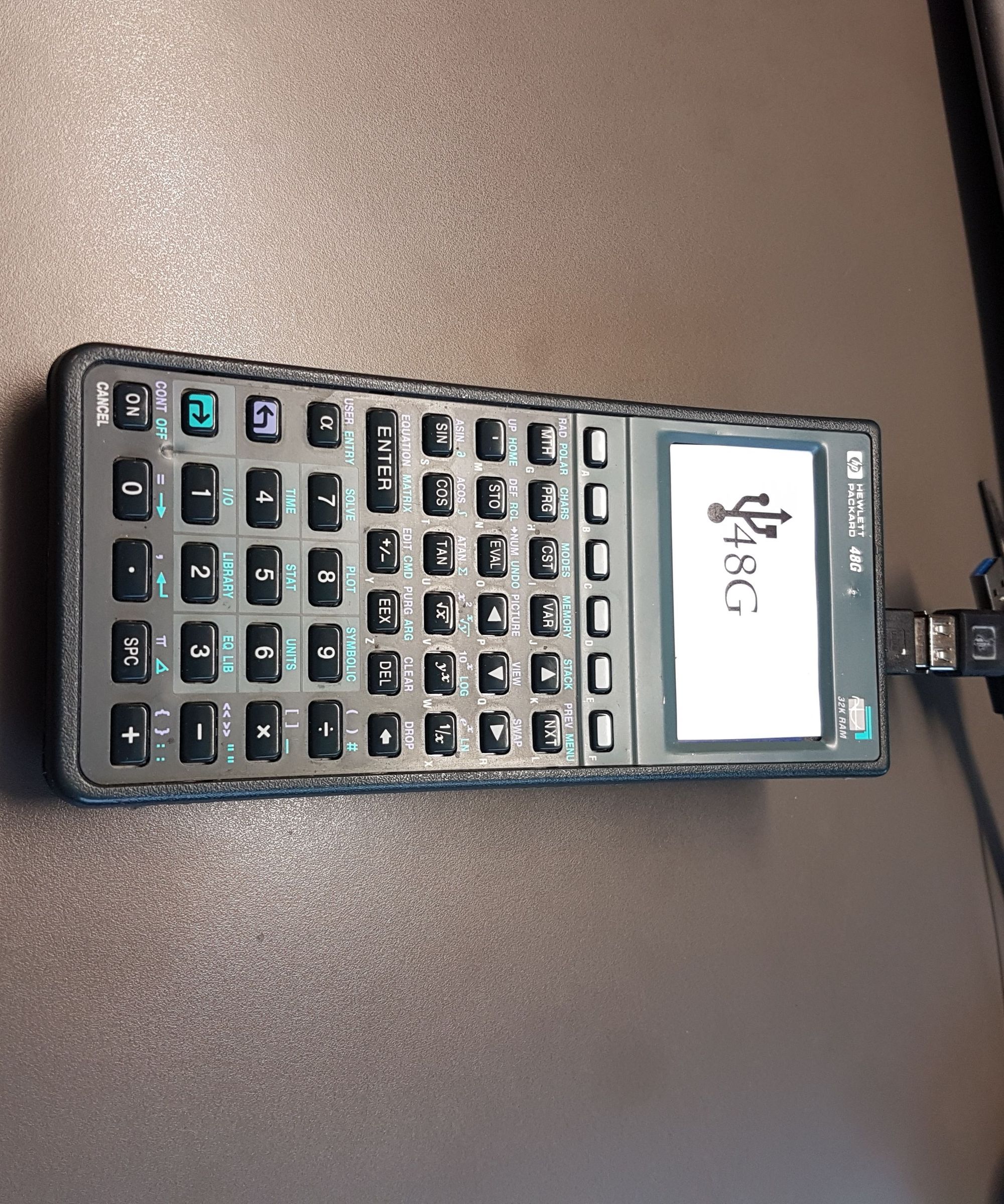

Please check out my priour project:
https://www.instructables.com/id/USB48G-Upcycle-Br...

Step 2: Bluetooth Modul
I used for this project:
* Adafruit Feather nRF52 Bluefruit AF3406.
https://www.adafruit.com/product/3406
* compatible battery (see Adafruit Manual)
* a lot of wires - better you have different colors
Step 3: Program Code (Arduino)
Code was creaded and uploaded with Arduino IDE over USB.
Your need to pair the keyboard with your computer/mobile phone.
No additional driver is needed.
Step 4: Soldering the Wires.
Additional 1MOhn resistors are used to prevent signal noise.
Connecting my keyboard was very tricky: I used bended springs of pens for the connectors - maybe you have a better idea.
