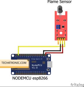

  • NodeMCU (ESP8266 MOD)
  • Flame sensor
  • Jumper wires
  • Breadboard
  • Phone with Wi-Fi connection
Step 2: Circuit Diagram

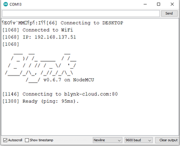

Step 3: Code

For further reading about installing and setting up BLYNK App also for code explanation visit its original post also for any issue either comment down below or on the original website.
