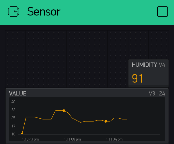

You can also:
- Send tweets and e-mails
- Plot & store hardware sensor data
- Bind phone App controls to any actions on the script side
- Control Arduino and other prototyping platforms
Get phone sensor data (soon)
and much more!
Next time, I will explain how to use Virtual Pins to do PWM and read advanced sensor data.
