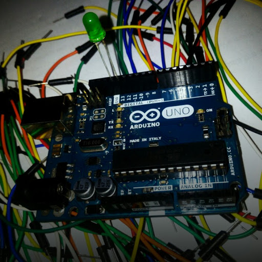

The ESP8266 module is a module that allows our micro controller to connect to a WiFi network or to create an access point for our devices.
The application that we will use for our form is "Blynk" downloaded for free from the Play Store. Through "Blynk" we can control the switching on and off of an LED through our WiFi network.

It is important to point out before mounting the circuit module that ESP8266 works with 3.3V voltages higher then you risk burning it.
Step 2: Electrical Connections
ESP8266:____________ Arduino:
GND -------------------------- GND
GP2 -------------------------- Non collegato
GP0 -------------------------- GND
RXD -------------------------- Pin 3
TXD -------------------------- Pin 2
CHPD ------------------------ 3.3V
RST -------------------------- Non collegato
VCC -------------------------- 3.3V
LED:____________ Arduino:
Anode -------------------------- GND
Cathode ------------------------Pin 13

    Here is the code that isn't available from the blog:
    #define BLYNK_PRINT Serial
    // Comment this out to disable prints and save space
    #include <ESP8266WiFi.h>
    #include <BlynkSimpleEsp8266.h>
    // You should get Auth Token in the Blynk App.
    // Go to the Project Settings (nut icon).
    char auth[] = “YourAuthToken”;
    // Hardware Serial on Mega, Leonardo, Micro…
    //#define EspSerial Serial
    // or Software Serial on Uno, Nano…
    #include
    SoftwareSerial EspSerial(2, 3);
    // RX, TX//
    Your ESP8266 baud rate:
    #define ESP8266_BAUD 9600
    ESP8266 wifi(&EspSerial);
    void setup(){
    // Set console baud rate
    Serial.begin(115200);
    delay(10);
    // Set ESP8266 baud rate
    EspSerial.begin(ESP8266_BAUD);
    delay(10);
    Blynk.begin(auth, wifi, “ssid”, “pass”);
    void loop() {
    Blynk.run();

    ubaz27
    ubaz27
    Reply 5 years ago
    download ESP8266.h library and Rename it to #include <ESP8266.h>
    it worked for me
    0
    mohir
    mohir
    Reply 5 years ago
    Thank you,
    by now realized i did not download the whole lib,
    so now all is working fine
