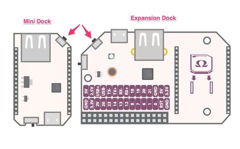

Step 2: Connect the Led
Now you can use a led. You can connect the led to the PIN number 11.
Use this pin because the pin number 11 is a free GPIO pin without I2C or SPI port.
Connect directly the anode led to the PIN number 11, and after putting a resistor on the led cathode, and the resistor to the Omega2 GND. In this mode, you allow passage of all the current through to the led, and use a resistor to avoid a short-circuit.
