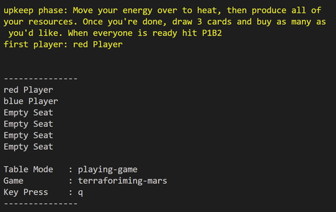

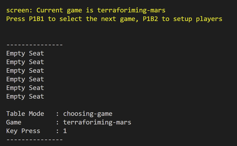

Now that all the leads are tied back to the control board and are registering keypresses, the program to control what lights up when should be easy. The idea was to light up one of the buttons, then when that button is pressed, light up the button to the left and so on. Unfortunately, it's not that easy.
What about games where turn order changes based on the game state? Or what about games where players can pass when they've done all the actions they can? I started hardcoding a unique set of rules per game, but after doing a few I realized most games seem to be made of the same phases. There might be more out there, but based on the games I own these phases covered all the cases I came across:
  • Upkeep: Set up for the next round, give players money, reset game components, etc. The "admin player" presses their button to tell the table when this is done. Most games have some kind of upkeep even if it's only at the very beginning.
  • Infinite Round: The first player's button lights up and they take their turn, then they press their button when they are done. When they do, the next player's button lights up and they take their turn. This continues indefinitely. This phase is used for simple games like Catan, Monopoly, card games, etc.
  • Finite round: This phase is the same is an infinite round except each player also has a second button they can press to "pass". When a player passes they are taken out of the rotation and they will be skipped over. When all players have passed this phase ends. This phase is used in games like Terraforming Mars, Nemesis, etc.
  • One shot: All player's buttons light up, then they take their turns in any order. Each time a player takes their turn their button goes out. Once all players have taken a single turn (and pressed their buttons) the phase ends. This phase is good when turn order is variable. This phase is used in games like Brass Birmingham, Who Goes There, Power Grid, etc.
  • One shot with turn order: This phase is essentially a finite round, but without a pass button. The first player takes a turn, then the next player, until all players have had a single turn, then the phase ends. The only game I've used this in so far is Arkham Horror.
In addition, sometimes the phases used change based on the number of players or the number of rounds that have passed. So, that's an extra bit of logic that needs to be coded. In the end I wrote a parser that would read through config files for each game and then handle the sequence of phases of the game.
Here's the config for a "General" game that can be used for simple games like cards, or Catan:

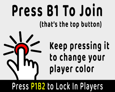

Step 9: Adding the Screen
You may have noticed in the previous section that there were a lot of images being thrown around in the game config files. About the same time I realized I had to write a different configuration for each game, I realized I could also show specific instructions for each game.
To accomplish this I attached a screen, made a buttload of images in photoshop, and figured out how to load them into the Raspberry Pi framebuffer to get them to display when they need to. This allowed me to show splash screens, instructions for joining the game, and instructions for each phase of a given game.
This has the added benefit of reminding new (or forgetful) players of the rules of a game and it does so in a context sensitive way.
