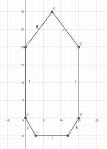

Step 1: Make Boat Structure
  1. Prepare a 30cm x 30cm Styrofoam, and at least 2.5cm (or 1 inch thick)
  2. Cut the boat like in the shape in the diagram (1 unit = 1 cm)
  3. Cut the wall for the boat to line up with the bottom of the boat in the diagram (7 cm tall)
  4. Stick wall and bottom of boat with type

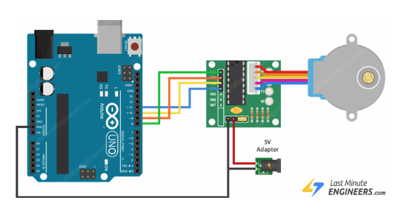

Step 2: Arduino Motor Wiring
  1. Carefully place both the Arduino board and the power module inside the boat in a secure and dry area. Make sure they are positioned in such a way that they remain stable during movement and are protected from water exposure.
  2. Connect the Arduino to the motor following the wiring diagram shown in the provided image. Ensure that the motor driver or control circuit is correctly wired to the Arduino’s output pins, and double-check all connections to avoid loose or incorrect wiring that might affect performance.
  3. Firmly attach the motor to the side of the boat using double-sided tape or another strong adhesive method. Make sure the motor is aligned properly to ensure efficient propulsion. Test the placement by gently shaking the boat — the motor should stay firmly in place and not wobble. You may reinforce the mount with waterproof tape or a lightweight bracket if needed.

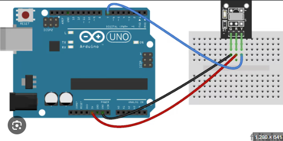

Step 3: Arduino IR Sensor Wiring
  1. Connect the IR sensor according to the wiring shown in the reference image. Carefully match each wire from the IR sensor to the appropriate pins on the Arduino. Typically, this will include connecting the VCC (power) pin to the 5V output on the Arduino, the GND (ground) pin to the GND on the Arduino, and the OUT (signal) pin to one of the digital input pins. Double-check the orientation and wire colors to ensure proper alignment with the reference image.
  2. Once you have completed the wiring, move on to setting up the code for the IR sensor. Open the Arduino IDE on your computer, create a new sketch, and begin by defining the pin connected to the IR sensor’s output. Write a simple code block to read the sensor's digital input and respond accordingly—for example, turning on an LED or printing a message to the Serial Monitor when the sensor detects an object. Upload the code to your Arduino and test the sensor to make sure it is functioning as expected.
