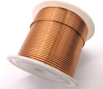

  7. Enameled copper wire.

Step 5: We Prepare the Coil
We roll the paper on a cylindrical surface with a diameter millimeter larger than the neodymium magnets and fix the paper so that it remains with that diameter, later, with 2 meters of enameled copper wire and leaving a 5cm margin on each side of the wire, We begin to roll it around the piece of paper so that it looks like the image, finally, we apply hot silicone around the coil so that it remains fixed. (In the image you can see two coils of different heights, both valid for different types of caps).
