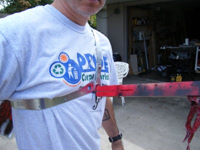

Start by bending the lumber connectors around your shoulder and under your arm. Go slowly and get the bend just right. After wearing it for even a short while, you'll come to appreciate taking the time to get it to contour to your body. When you have both lengths of connector bent to conform to your torso and overlap like in the pictures, you can mark where they need to be drilled (unless you get lucky and the existing holes in the connectors line up). This is a case of purely eyeballing it and drilling approximately where you think it will work.
Step 3: Step 3: Complete the Rig

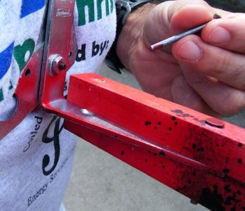

Once those crucial first holes are drilled in the lumber connectors, you can use nuts and bolts to hold it all together. This is where the L-brackets come into play. They support the sign itself. Fit the L-bracket like in the picture and drill your second hole where needed to keep the bracket from swinging from side to side on the first nut and bolt. Do I need to remind you to put the nut on the outside of the rig? You don't want them rubbing on your torso for the duration, although they would probably add some realistic blood to the costume.

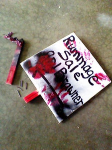

This is pretty easy. Get the garage sale sign or election sign, whatever, and cut it off squarely beneath the actual sign portion, but leave as much post as the length of one side of the L-bracket! This is terribly important. You must have enough wood there to secure the sign to the L-bracket. If you do not do this, you cannot secure the sign to the L-bracket properly.
When this is done, you'll have to cut a trench up the middle of both sides of the wooden stake. Cut into the wide side of the stake and make sure the trench is the same thickness as the L-bracket. Dry fit both sides to the L-brackets and mark along their sides where you want to drill the holes for the pins that hold the sign parts to the L-bracket. Remember to make the pins pretty snug to the outside of the L-bracket holes. Better to have to struggle a bit to get the pins in place than to have your sign wobble all over as you walk.
