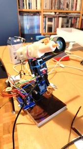

There are 4 predefined positions that are approached immediately. The idea is that if I spot a Boesling on a CatCam, I first have to connect remotely, open the website and use the navigation keys to navigate to the destination. Then turn on the lamp and fire the gun. At this point, every cat is out of the woods! The POS keys do all this for me, and I can at least catch the tip of a Boesling's tail ;-)
If the "Aim & Fire" option is checked, the flashlight and water gun will also be launched.

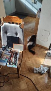

Step 2: Prototype
I would suggest making the device as high-quality as possible because it should work outside in the rain or even in winter when temperatures are below zero.
My first prototype was built with this cheap plastic touretts [Amazon.de link] available on the Internet. The whole thing was extremely wobbly and the small micro servos were too weak to hold the load.
Fellina doesn't care about the mess during prototyping as long as there's enough to eat :-)

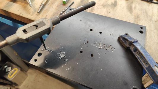

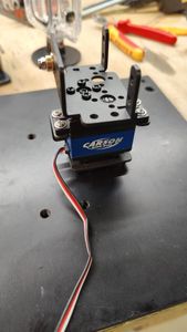

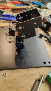

Step 3: Final Version: Turret

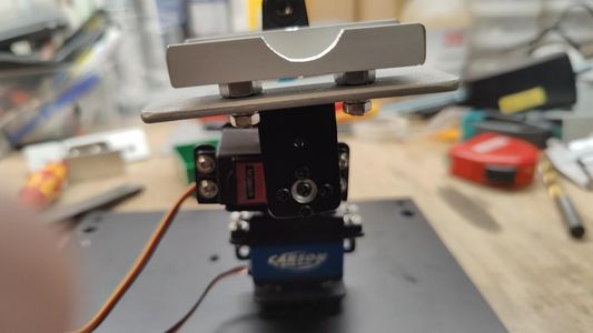

I shortened the upper servo-arm to get better torque.

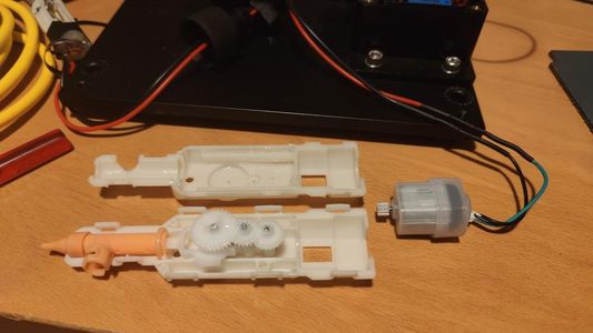

Step 5: Final Version: Watergun

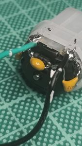

Dismantle the water gun and tuninig the motor.
I equipped the motor with a freewheeling diode and interference suppression capacitors. (https://custom-build-robots.com/raspberry-pi-elektronik/raspberry-pi-roboter-elektrische-stoerungen-der-entstoerkondensator/7930)

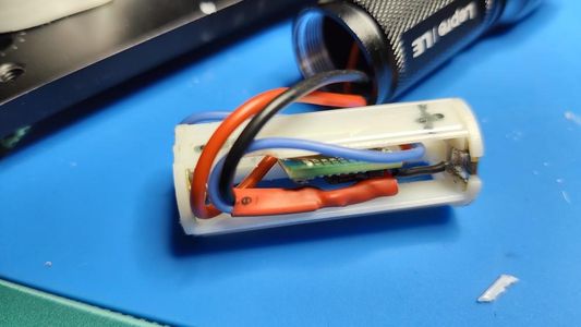

Step 6: Final Version: Flashlight
Instead of batteries (3x1.5V) I use an adjustable step-down converter. I had to learn it the hard way that with LED flashlights every 1/10 V counts. At the beginning I used 5V DC and after a few tries the LED lamps burned out :-(

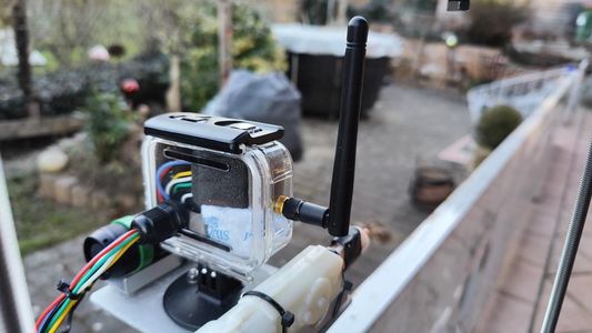

Gluing the tiny antenna plug is recommended. I use the programming board as an additional option and soldered the wires there. This means the cam fits better in the housing.
The cam only holds by being clamped with various foam rubber blocks.
In addition, a small packet of silica gel is included to absorb the condensation.

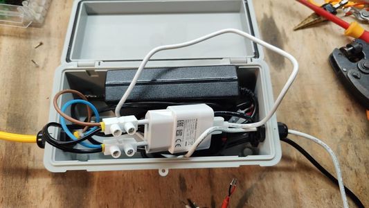

Step 8: Final Version: Electric Box
This is still the box with the power supplies from the first version, but the current version is basically the same...
(The video above shows the new and larger green box)
I use a 230 VAC cable to power both devices (yellow one from the left). The USB plug-in power supply is used to supply the ESP and the peripherals, the large power supply for the motors and pumps and the flashlight, see circuit diagram.

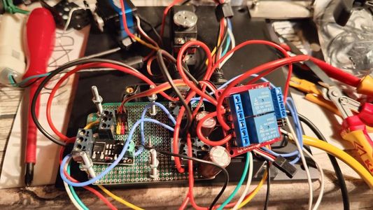

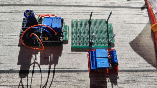

Step 9: Circuit Diagram
The circuit diagram is not too complex, I use two independent 5V power supplies to avoid any EMC interference.
In the 3rd (and last!) version of this project I use a 5V@12A (! there was no smaller one available ;-) power supply for LED strips. It is waterproof and strong enough to absorb the extreme voltage peaks of the water gun's simple pump motor. The original switched-mode power supply always switched off briefly due to the peaks, which is unfortunately not usable.
Nevertheless, I use a buffer capacitor (1000µF) for both voltage sources.
Both sources are independent, but the grounds are connected.
The relay shield also works with 3.3V from the ESP32, and it is possible to change the logic via jumpers. This is important because the ESP's GPIOs are 'high' during booting and the cannon might start firing...
For the LED flashlight I use a MOSFET (motor driver) to be able to switch it on and off every hundrets of milliseconds.
I use a relay shield for the pump motor.
