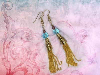

Introduction: Boho Chain Tassel Earrings With Beads
I don't remember the first time I saw chain tassels but I remember how much they stopped me and made me look. They look so fun and sophisticated. In this Instructable, I'll show you how to create stunning Boho chain tassel earrings using Tibetan bead cones topped with gorgeous glass beads.
The best part? These earrings are not only visually appealing but also quick and easy to make, making them a perfect project for beginners. So, get ready to unleash your creativity and elevate your style!

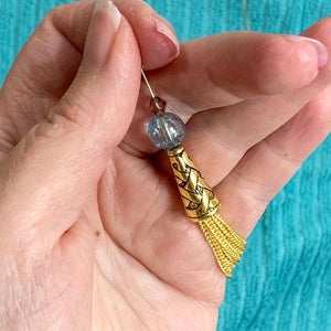

First, push the wire at the top of the tassel through the bottom of a bead cone and out the top (first photo above).
Next, you will add your beads on top of the cone. To choose your bead arrangements, keep these thoughts in mind:
- Don't let the beads outshine your star. These are little spots of color meant to accent the fun chain tassels you just worked so hard to create.
- Size matters! These are hanging from your ears, so don't choose something large and made of porcelain that will pull too hard. Also, you'll want to keep your bead arrangement under 5/8" long to make sure you have enough wire to create a wrapped loop in the next step.
- Mix it up. It's more fun to choose 2 or three beads of mixed sizes and colors rather than one large one. You could stack three beads from large to small, three that are small-large-small, or two beads of two different sizes. The variation in sizes creates more interest, just like in art. You might also consider a mix of metal spacer beads and colored beads to allow the colored ones to stand out more. Or mix up textures and colors like I did. My blue bead is cracked glass and the purple one is a smaller faceted glass bead.

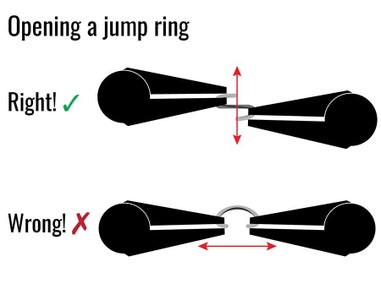

Open a 4mm jump ring by twisting it and not pulling it apart (see second image above). Put the loop from your tassel on, then the ear wire, and then close the jump ring by reversing the twist. Sometimes you have to twist a jump ring back farther than its cut point, and back again to get it to line up properly.

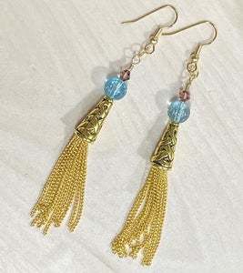

Step 6: Your Earrings Are Ready to Wear!
Creating your own Boho chain tassel earrings opens up a world of possibilities for expressing your unique style. Don't be afraid to experiment with different chains, bead colors, styles, and arrangements to create earrings that truly reflect your personality. Let your imagination run wild and create earrings that are as individual as you are!
