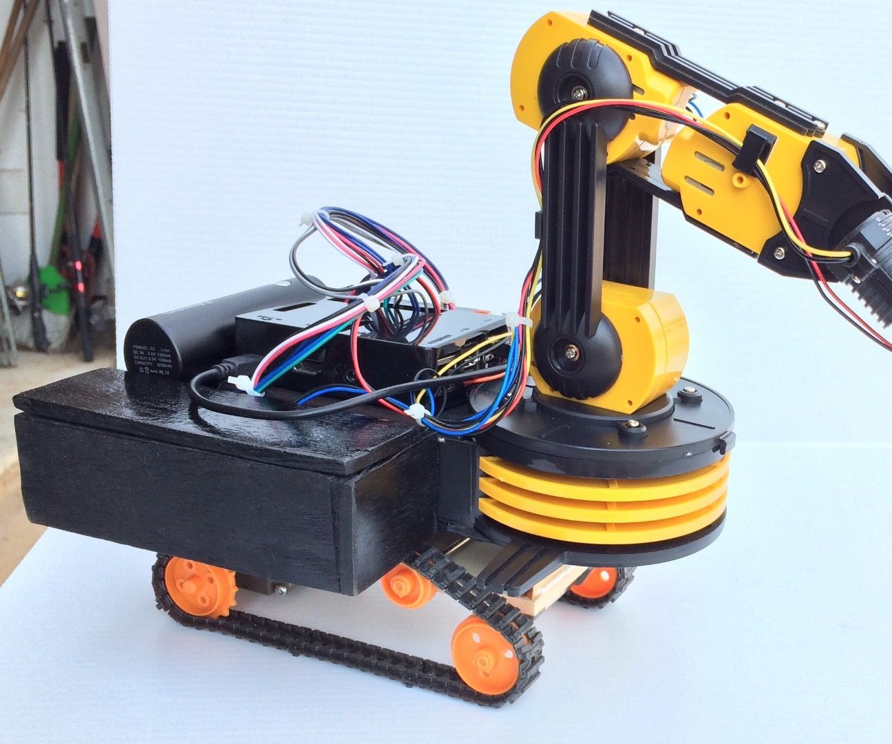

First we need the OWI-536 All Terrain 3-in-1 RC Robot Kit, I purchased one from Amazon for around $40. The robot comes in many pieces as shown in the first picture. The second picture shows the track motors and gearbox being assembled. The robot can transform into three different styles. I wanted the one with the grabbing mechanism.
Step 4: Add the Electronics Compartment
We need a place to put the 12 volt battery, the motor controllers, the Raspberry Pi and the 5 volt battery. I glued a mounting block on top of the robot and constructed a wooden cabinet that sits on this block and the fork lift arms on the back of the robot.
Step 5: Add Lights and Camera
Mount the two lights on the top cover. Put the camera in the case and mount it to the pan and tilt mount. I didn't use the pan servo, just the tilt. This is needed to see out front to know where you are going and then when you get close to the object you want to pick up you can look down for a good view of the gripper.

Step 10: Here Is the Final Package
Here is what it looks like in operation. The third photo is the view through the camera. I hope I have inspired someone to give this a try. Let me know what you think about the project.
