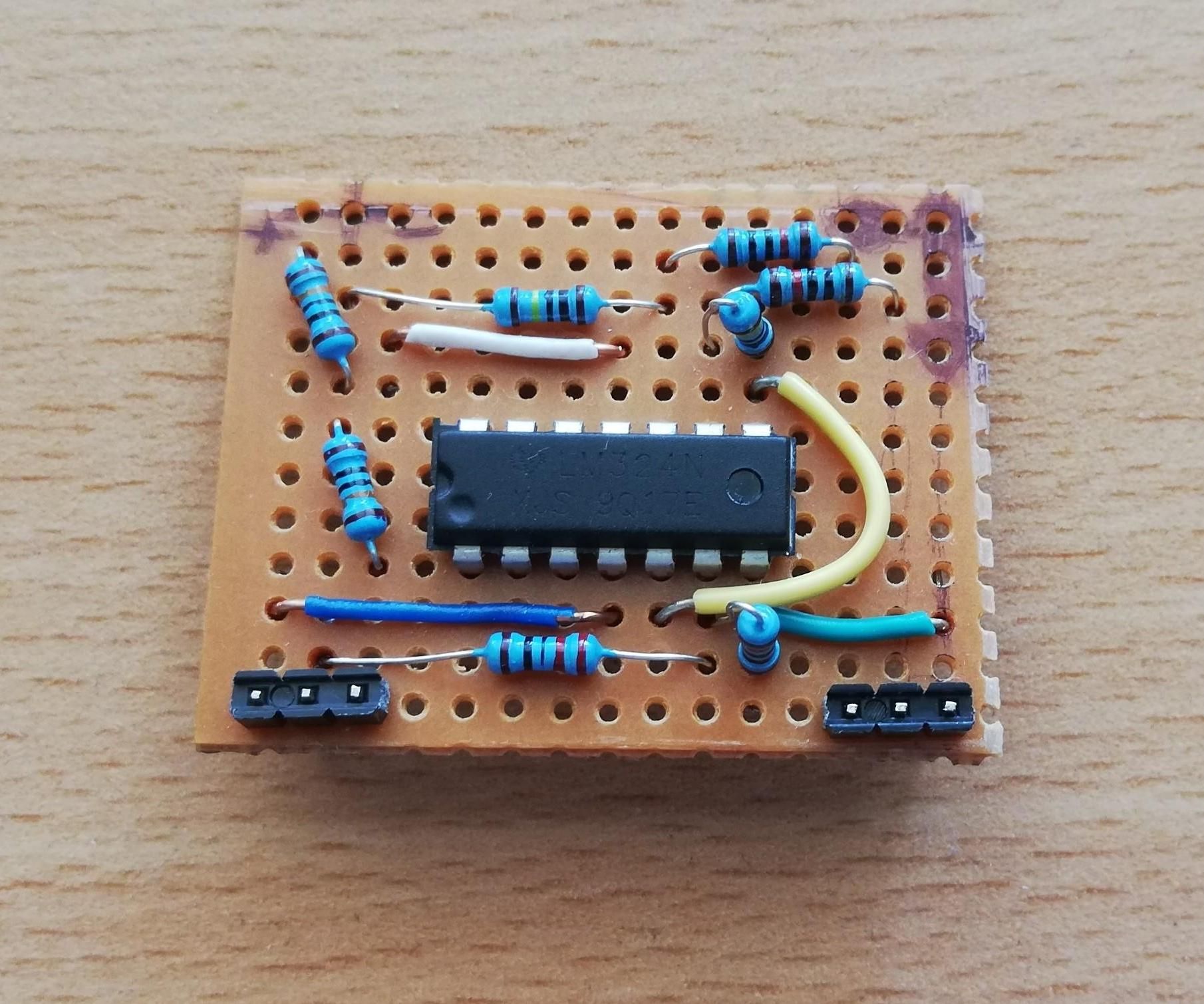

The device consits of the amplifer board and the bone transducer circuit.
Amplifier Board:
-note the amplifier circuit layout; the bottom is for power and input signals, and the top is for the outputed amplified signals.
-The stereo audio socket (3 connections) should be connected to the bottom left minding the R,L and GND signs. This is where the male to male audio cable connects to (with the other end being plugged into your computer).
-Each individual mono audio socket should be connected to the top of the amplifier circuit. The orientation is not important although the -ve output terminal should connect to the larger/outer contact plate of the audio socket.
-Connect a suitable (socket for) power source to the bottom right of the amplifier circuit minding the polarity. The power source should produce around 3-5V. This can be a lithium ion battery, 2AA batteries or a 5V power bank. Do NOT use a power adapter connected to main to ensure total circuit isolation. Beware that any noise in the power source could be amplified and be heard when using the headphones.
