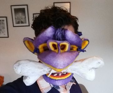

The idea was that the beastie would have a few long, needle-like teeth, which would be put in right at the very end. The final step would be to glue them in place, and that would forever trap the bone in the mouth. The teeth were formed by wrapping strips of paper tightly around lengths of wire. The first set were way too long so I cut them back and tried again. I made myself an assortment so that I could reach my final decisions later.
Here I am posing with the teeth temporarily inserted, just to make sure it worked and because I like to take pictures of myself with masks on.

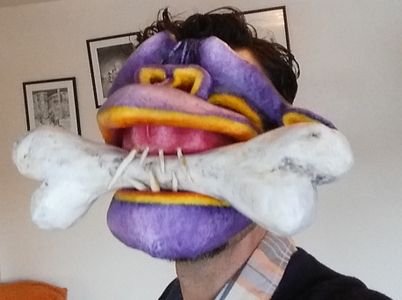

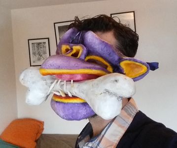

Step 6: That Difficult Paint Job I Was Telling You About Earlier
Yeah, so here's that part. I love this part, seriously. But it was pretty tough! As expected, the transitions between the gums and lips, and all the transitions between yellow and purple, were hard to do effectively.
The actual process took a couple of days, experimenting with layering the tones until a subtle balance was struck. I'm not sure how much of that detail comes through in the photographs! Even in person, on close examination you may not appreciate the appalling amount of fuss that went into it. You're probably an obsessive-compulsive crazy pants if you do!
The last step, as previously revealed in a veritable orgy of irresponsible foreshadowing, was to glue in the teeth. If you've never used Krazy Glue or similar substances, just know that they are violent, caustic chemicals that will likely cause some sort of discoloration to your delicate paint job. I knew that and didn't care, I just painted over it after it was done. The whole thing was then given a few coats of satin varnish.
One final thing:
A couple of weeks later, after having finished yet another mask, I went to a local bead shop and purchased a handful of small round wooden beads with large holes. The problem was that with all the work (by which I mean, again, "appalling amount of fuss") I put into the masks, it seemed a shame that the faces should find themselves besmirched by the unsightly knots of ribbons being used to hold them up.
So I got the wooden beads and I painted them to match the beastie's healthy purple skin tone, and I replaced the over-the-counter ribbons with purple fabric ties that I whipped up on the sewing machine in my mom's basement, when I was doing laundry over there while she was out of town.
What do you think? Overall I am pretty happy with this project! It's not as interesting to me, conceptually, as the Toadstool mask, but it presented some interesting opportunities for problem-solving. And, I succeeded in the "freebone" experiment that started off the whole process, so I would definitely call it a modest triumph, at least in terms of meeting my intended goals.
