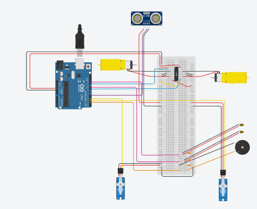

Step 2: Building the Circuit
Setting up the hardware for Boo-Bot is straightforward. There are two separate loops: one for the geared motors and one for all other components.
  • Arduino Board: Connect the Arduino UNO board to your computer via USB cable.
  • Ultrasonic Sensor: Attach the ultrasonic sensor to pins 7 (trig) and 6 (echo).
  • DC Gear Motors:
  • Connect one motor to pins 8 (forward) and 12 (backward).
  • Connect the other motor to pins 9 (forward) and 11 (backward).
  • Servos:
  • Connect the first servo to pin 5.
  • Connect the second servo to pin 3.
  • LEDs:
  • Attach one LED to pin 13.
  • Attach the other LED to pin 10.
  • Piezo Buzzer: Connect the buzzer to pin 2.
  • L293D IC: Utilize the L293D IC to regulate the DC motors.
  • Breadboard: Arrange the components on a breadboard for convenient connections and adjustments

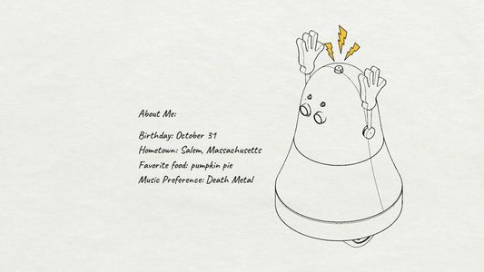

Step 3: Assembly
Boo-Bot's design is segmented into three components for practical reasons. The head houses permanent fixtures like the ultrasonic sensor, LEDs, and buzzer. The body holds the servo motors in place, with a vertically positioned breadboard and Arduino situated on a shelf. This division facilitates easy assembly and accessibility for calibration. The robot is assembled upside down, starting with the head, followed by the body, and then the base.
