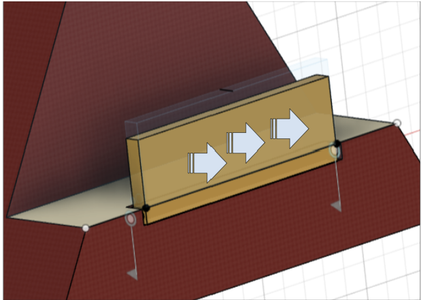

Step 3: Joints
I’ve highlighted the lip in yellow for help in distinguishing later on.
Using a Rigid Joint, connect the rod and the lip. Use another rigid joint to move the rod and lip Down into the hollowed out area.
Finally, create a Revolute Joint on the lip, and set it to 90 degrees of movement.
Congratulations! You’ve successfully finished The BookShelf. To test out your movement, right click on the upside-down flag, and choose Animate Joint Relationships
Your lip will begin to move. Press Esc to stop the simulation.
