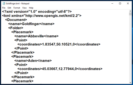

The main idea of this project (Fig. 1) is to get all the geographical names from the text, then get coordinates to a special kml-file and finally draw the map according to these points.
Let's see a detailed scheme (Fig. 2).
First (1) we need to load the book in txt-format. Then - prepare the database (2) with data fields: object name, latitude, longitude. We plan to use "GeoNames" resource.
Then our tool need to execute first request to get the list with all the words started from the capital letters (3) (except some unusefull items: "He", "the", "Why", ...). Next task is to find combinations among the "capital"-words (4). According to this scheme the list of words need to be reduced from step to step. So, on the next stage (5) there is a difficult semantic analysis - to divide geo-object (GO) and a living beings (LB) (according by frequency of using (LB >> GO) and associated verbs ("go", "think", "run" for LB)). After that we can remove duplicated Geo-names from the current list (6). At the next stage (7) our tool gets geographical coordinates from the database files according to a current list of names. After that the list can be also reduced. At this moment we need to be able correct the list of Geo-names manually. We plan to draw map on a Google-Maps, so the last thing that "Book-Mapper" do is KML-file generating (8). This xml-text-file can be loaded into Google-Maps directly to get a map (9).

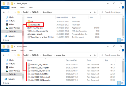

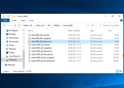

For our project we need to have geographical database which can be downloaded from "GeoNames" resource (https://download.geonames.org/export/dump/). Then for each base it need to prepare three separate files for "names", "latitude" and "longitude" (with the same index positions). These files will be used by "Boor-Mapper". You can download examples by this link.

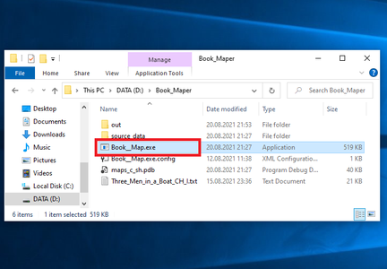

To get compiled project go to "YOUR PROJECT FOLDER LOCATION" > "bin" > "Debug". Executable module of your project will be located there (don't forget to create folders "out" and "source_data" at this location; "out" - for results, "source_data" - for geo-databases (see previous STEP)).

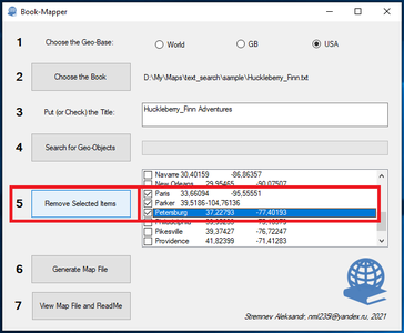

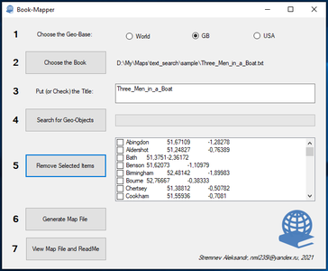

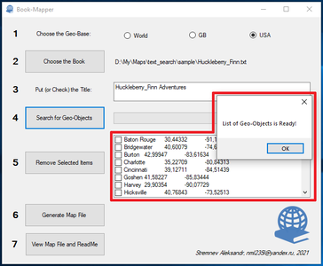

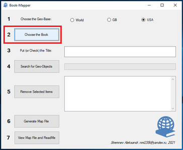

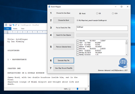

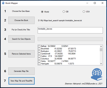

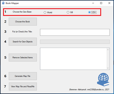

Step 5: Tool Usage: Book-Mapper Stage
Perhaps you have got "Book-Mapper" at last (by assembling a C# project or by downloading ready executable module. Now you are ready to create map according to your favorite book.

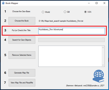

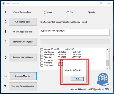

First of all create kml-file for txt-document (with book content) using "Book-Mapper" (Book__Map.exe) by the following sequence:
Run "Book-Mapper" >

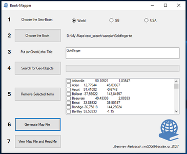

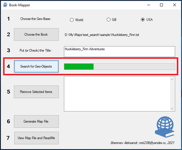

> "Choose the Geo-Base" (World | GB | USA) >

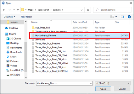

> Click on "Choose the Book" and select the book in txt-format >
> "Put (or Check) the Title" >
> Click on "Search for Geo-Objects" (wait a bit ...) >
> Select useless items in a result-list and click on "Remove Selected Items" >

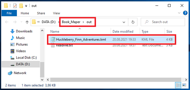

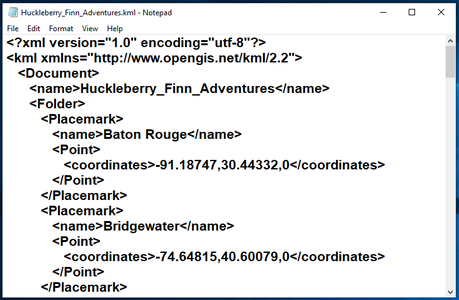

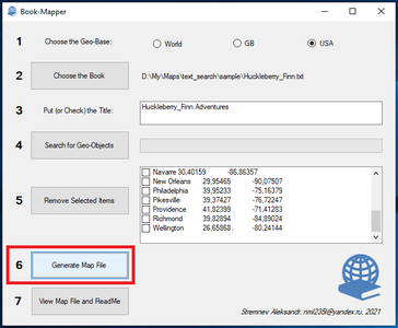

> Click on "Generate Map File" >

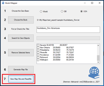

> Click on "View Map File and ReadMe" (to get kml-file for your book)

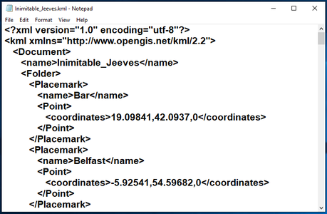

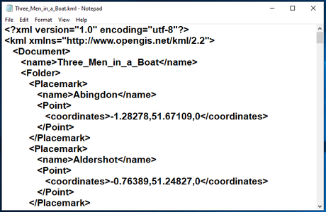

Here is some examples of "Book-Mapper" working (see images):
1) "Three men in a boat (To say nothing of the dog)" (by J.K. Jerome)
2) "The Inimitable Jeeves" (by P.G. Wodehouse)
Try project using links(for execute, for C# project assembling).
