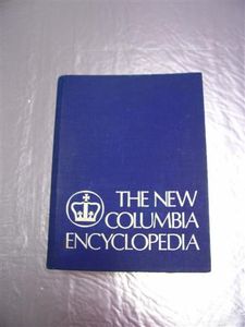

Step 1: First, Get Yourself a Case-bound Book With Some Artistic Covers
If you paid as much money for textbooks as I did, which are now very much out of date, you may at least have the consolation of the artwork provided by the publisher on the covers
If you are in need of books to use for this project then ask your school or local librarian if she (or he) can provide you with any that have been withdrawn from circulation. Once a book in a library looses favor among readers you can usually get the artwork for free.
