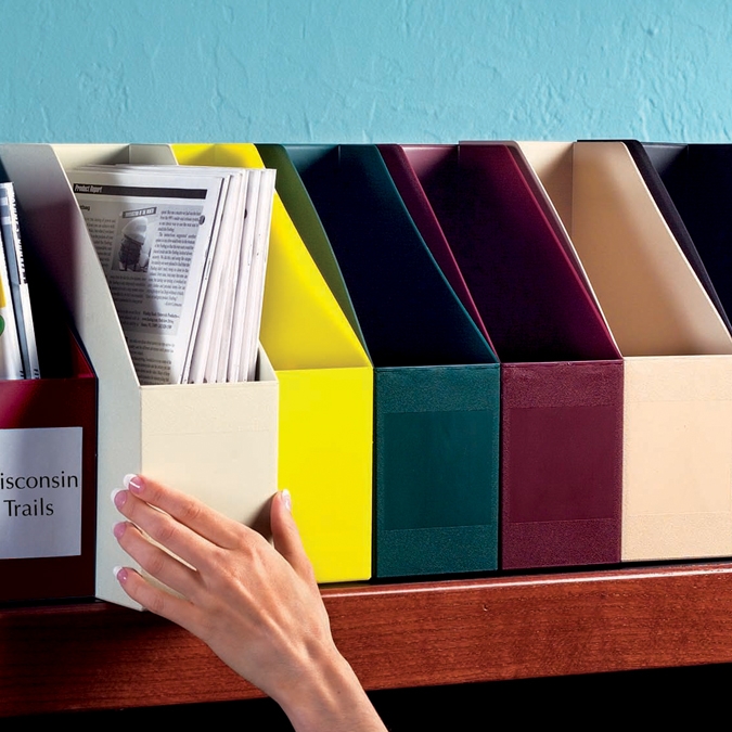

Step 1: Preparation
1.Mesure the size of your book self (For example: our book self size)
2.Deside the setting (In our case, we use three cut corner file cases and two books)
3.Prepare All Materials following the list
