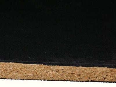

The black paint is not just to seal the particle board and provide a nice contrast with the stained wood that will be around it; flat black paint converts the rough and rather ugly texture of the pressed board into something that looks more like a high-end solid surfacing material. The photo shows how nice the black surface looks compared to the unpainted, unrounded, raw back edge. Further, the latex wall paint will seep into the wood significantly, so that minor scratches that happen later will still look black. In short, flat black paint can hide a multitude of sins.

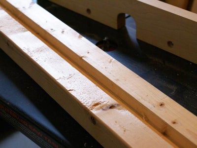

Using the 3/4" bit on the router, set the guide to cut at least 3/4" from the edge (see the figure in step 5). Now take the 2X4 and cut a 3/4" wide by 3/4" deep slot lengthwise as shown in the figure. You'll probably want to do that in 3 or more passes, going a little deeper each time. If you don't have a router with a fence or a router table, you can use a table saw to nibble out this slot.
The precision of the width of this slot is critical, so take your time and keep things well aligned from pass to pass. The width of this slot should precisely match the thickness of the raw pressed board. A tight fit is good, a loose fit is very bad.

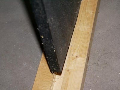

The back edge of the black particle board now gets glued into the slot in the 2X4. This should be a very tight fit, because the black paint raised the "grain" on the particle board a little, but that's ok.
Lay the slotted 2X4 on the floor with the slot facing up and run a small amount of wood glue down the slot. Then start to insert one corner of the particle board and use your weight to slowly force the board all the way in and then flat. A slight rocking motion sometimes helps.

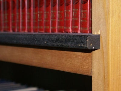

The result is a handsome black shelf with a stained wood "stop" at the back.

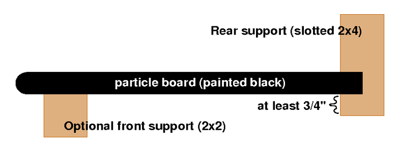

One might think that we have just made the particle board as rigid as the 2X4 -- but this is far more effective than, for example, screwing the same 2X4 under the board as a support. Why? The slot prevents the board from bending over its entire back edge, rather than just at a few screw points (and particle board doesn't work well with screws). It also is very effective in spreading the load on the shelf. Further, the fact that the 2X4 is in the 4" tall orientation, rather than 2" tall, makes it more rigid.
If you're truly paranoid or just like how it looks, you also can glue and screw a 2X2 (or even another 2X4!) under the front edge, but it's really the rear support keeping the pressed board from bending that makes this shelf sag free. The figure shows a side view.

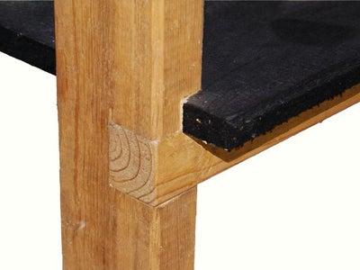

So, here's the style of bookcase I've been making and using for about 20 years. There's really not much to it beyond what we've already covered. A couple of upright 2X4 posts go on each end, and the shelves tie into them with some very simple slotted joinery. Basically, the rear slotted 2X4 is 1 1/2" shorter than the shelf, and the shelf is supported by 3/4" deep slots on each of the four 2X4 posts.
Note that you don't really need any fasteners for any of this, although I've sometimes used a few screws primarily to help hold things tight while glue is drying. Screws are really only effective when the thread is holding in a piece of 2X, not particle board. I glue the shelves into the post slots, but bolts could be used instead to allow disassembly.
If you're paranoid, or you're making a workbench which is significantly deeper than a shelf, or you just feel like it, simply add a 2X2 front support which is 1 1/2" longer than the particle board, and set it into the 2X4 side posts as shown in the first figure. The second figure shows a close-up of the bookcase shown at the start of this Instructable -- which uses a 2X4 in the front, but doesn't have it set into the posts.
