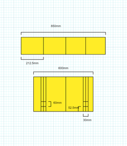

This part requires measuring equipment, such as a ruler and measuring tape. with the platform board, start by drawing the board into quarters. On the wall board, draw the board into half and line it up center with the platform, side by side. then, measure the difference between the edge of the wall board and the midpoint of the plastic part and mark it. Next, mark the width of the plastic part onto the wall board, as well as where the screw holes are located. Ensure all measurements are exact as any differences will result in misfit. I have listed the precise measurements needed for the boards below.
