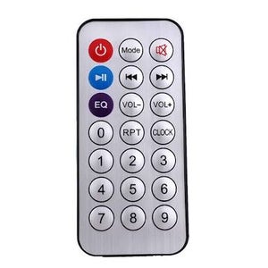

- FM radio
- IR remote

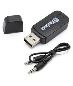

- Car Bluetooth module

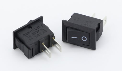

- Switches

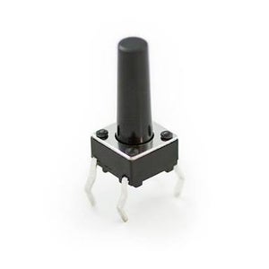

- Push button switches
- IR sensor(TSOP1738)

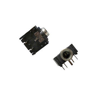

- 3.5mm Audio female jack

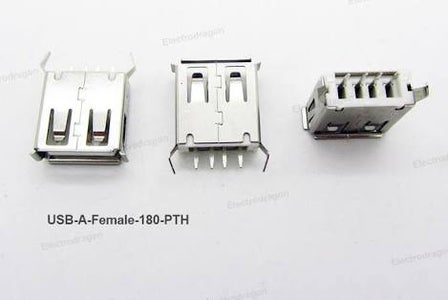

- USB female

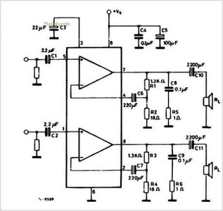

Step 2: To Make Amplifier....
If you don't have amplifier, don't worry
Here is circuit diagram.
---components for amplifier---
IC-TDA2007A
R1-1.3Kohm
R2-18ohm
R3-1.3Kohm
R4-18ohm
R5-1ohm
R6-1ohm
C1-2.2µF
C2-2.2µF
C3-22µF
C4-0.1µF
C5-100µF
C6-220µF
C7-220µF
C8-0.1µF
C9-0.1µF
C10-2200µF
C11-2200µF
soldering all components as per circuit diagram on PCB.

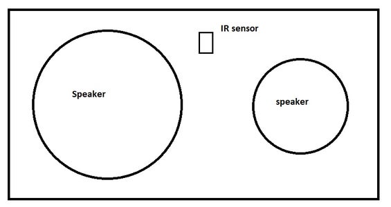

Step 3: NOW Make Wooden Body.
Here i designed this model.and cut the plywood.and joined it. I use wooden glue to join all parts.
and i use drilling machine to cut circles foe speakers.

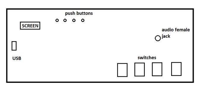

Step 5: Fix All Switches and Others
all ON/OFF switches,push switches, 3.5mm female audio jack,usb mp3 player module stick on wood.

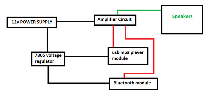

Step 6: Now Time to Wiring
Here i shows you basic block diagram.
Power supplying all things..

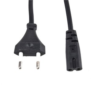

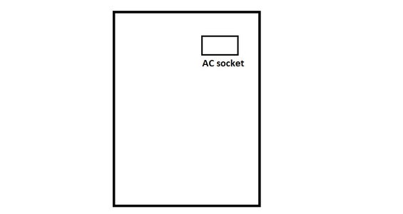

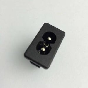

now two wires comes from AC socket,one of them hot wire and another one is neutral wire.

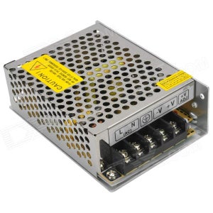

Here we place one (s1)switch at hot wire and connect both to the power supply.
Then after output of power supply set at 12v, And connect +terminal to any one terminal of (s2)switch and second terminal of switch connect Amplifier Vcc. And the GROUND terminal connect ground of the amplifier.

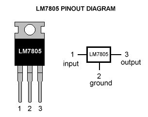

here we have 12v power supply we should have to need to regulate it to 5v.
Here we can use LM7805 ic to do it.
now connect positive(+) terminal of 12v to 1 pin of ic.
And ground to 2 pin
Then we get 5v to the output pin 3.
For more details of LM7805 IC click here.
After doing this process supply 5v to he Bluetooth and mp3 module put separate switches to Bluetooth module and mp3 player module.
Step 8: Wiring of Signals
Bluetooth module output is connect to the input of Amplifier.

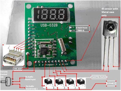

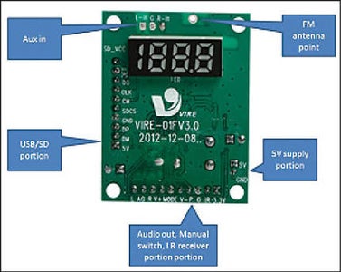

Now mp3 player module have 3 pins of
G-ground
R-right
L -left
this is audio output pins.
connect it G to amplifier's input ground,R to right and L to left of amplifier input.
all connection of mp3 player module shows in figure.
Step 9: Aux Playing Mode
now connect Amplifier inputs to 3.5mm female audio jack
Step 10: FIX EVERYTHING IN TO THE WOODEN BODY
Fix the speakers and other parts using screws.
