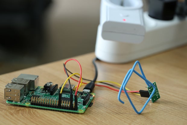

To do that we need to connect a RF (radio frequency) antenna to your Raspberry Pi, configure it then pair it to RF sockets.
You need to solder the RF transceiver and home-made antenna together. Make sure the soldering connects the antenna to the ANT port on the RF transceiver.
You can have more information on how to make an external antenna in this article.
Keep in mind that the required length of your antenna will depend on the frequency of your RF socket. Our OS supports 433, 477 and 315 MHZ.
Once soldering is done, plug three jumper wires to your RF transceiver (433/477/315 MHZ).
VDD = Electric current (5V)
GND = ground (select a ground PIN)
DATA = has to be connected to GPIO23
You can connect those three jumper wires as we did on PIN 2 (5V), PIN 6 (GND) and PIN 16 (GPIO 23).
The last step is to connect the configured antenna with the RF socket.

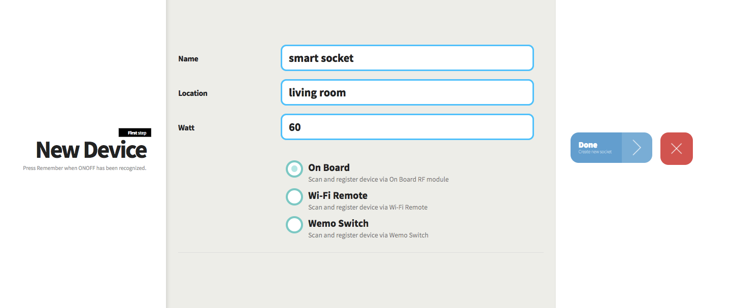

- Open App Libraries and download ON/OFF app
- Click on “Add socket”
- Type-in the details, select “On Board” and click on “Done”
- The app will start scanning the surrounding sockets. Press and hold on the socket’s button until the LED blinks
- When the LED stops blinking and stays on solid red, it means your Prota Pi has paired with your socket. You can then press on “Remember”
You can now try turning it on and off via the app interface.

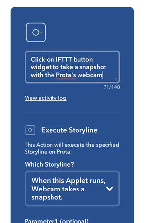

- When IFTTT applet run, Webcam take a snapshot then sends to Telegram bot ⇒ LINK

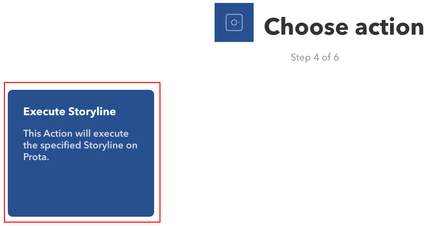

It’s now necessary to create the IFTTT applets that will connect Google Home to our previously created storylines
- Create your account on IFTTT
- Search for the channel “Prota”
- Click on “Connect” and select your Prota (you need to use a device which has been granted a Prota Space access)

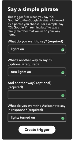

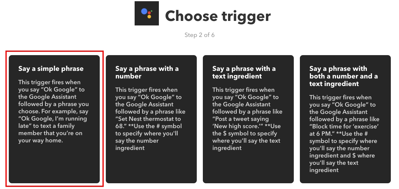

- Search for the channel “Google Home”
- Click on “Connect” and identify with the account linked to your Google Home
Next, reproduce or use the following applets:
If you say "lights on" then execute "smart socket" storyline

If you say "take a snapshot" then execute Snapshot storyline
