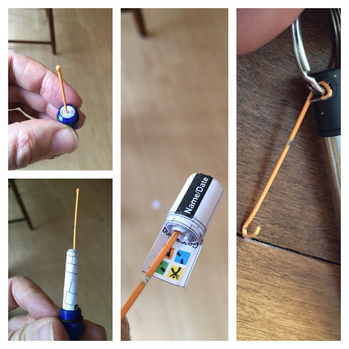

You will need at least a meter of thin coated electrical wire, as pictured.
On the bottom of the circuit board you will see a stiff wire protruding about 1/4 inch from the circuit board. That’s the built-in antenna. We will solder our wire to the TOP of that antena, thereby extending its radio range.
Find the spot on THE TOP of the case, indicated in the picture, where the wire should protrude, and mark it with a thin sharpie.
Choose a drill bit slightly wider than your electrical wire, and carefully drill a hole at that spot.
Step 3: Solder the Electrical Wire to the Internal Antenna
Then carefully reassemble the sensor.
Step 4: Trim the Antenna to One Meter
Long story short: trim the wire to 1 meter.
Step 5: Reattach the Sensor to the Door/Window
Using strong Double-sided tape, reattach the sensor and its magnet close to each other across the gap, as usual. And tape the antenna above it, as pictured.
