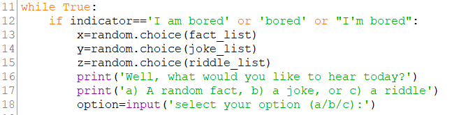

Line 11-- The 'while True' loop:
The 'while True' loop is super useful because it allows everything inside it to be repeated indefinitely, or until there is a break command (to 'break' out of the loop). This will come in use if you want to play this multiple times.
Line 12-- 'If' statement
The if statement provides a condition that must be fulfilled in order to move on. For this code, the user has to say something along the lines of 'I'm bored'.
Lines 13-15-- Random choice
This simply chooses a random term from the list we made in the previous step.
Line 18-- User Import
stores user's selection as the variable, 'option'.
