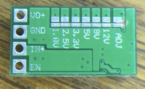

The Bluetooth module requires 5 volt power, so I was hoping to find a 5 volt supply being provided by one of the SoundDock pins. From the most recent iPod docking station specification, this should have been on pin 23, but voltage readings showed no such thing. Instead, it seems that the Sounddock follows the older specification, and only sends power to the 30-pin connector's "Firewire" power pins (19 and 20). My tests showed 16 volts on the pin, but this voltage is much too high and would damage the Bluetooth module, so if I wanted to power the module from the SoundDock I would need to drop the voltage to 5 volts. I knew from my other projects that there are very small and inexpensive DC-DC "buck" converters that can do that quite easily, so problem three solved.

Step 3: Set the DC-DC Converter for 5 Volts
Before you start to wire the components together, you have to prepare the DC-DC converter so it delivers 5 volts. By default this is configured to be adjustable via a very small potentiometer on the board. However there are also resistors on the board that set the voltage to a number of different common voltages. Rather than fuss with setting the potentiometer, I followed the board's directions to use one of the onboard settings, by cutting the connection between the 2 pads for the "ADJ" option (repeated scraping cuts with an exacto or similar sharp knife does the trick), and soldering a bridge over the to pads for the 5V option. The pictures above show the two modifications you need to make to the board.
