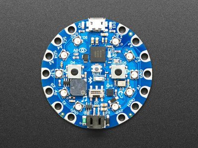

  • CircuitPython Bluefruit microcontroller (Accelerometer and Neopixels)

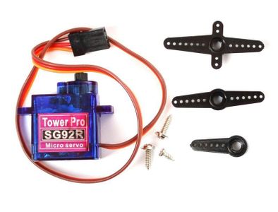

  • TowerPro SG92R Micro Servo

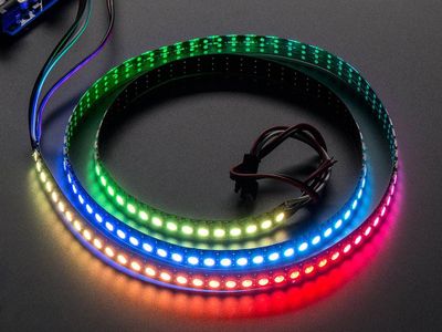

  • Strip of LED Lights (30)
