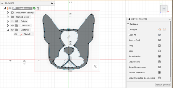

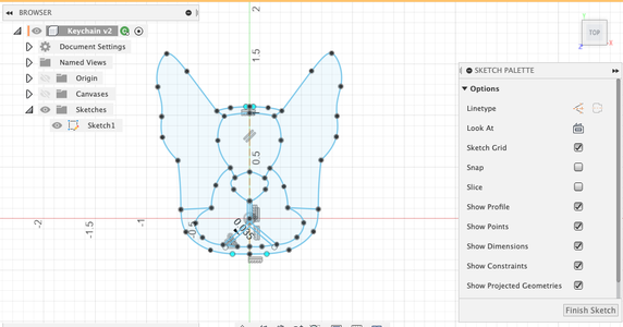

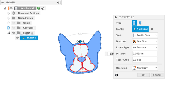

I designed this coin in Fusion 360, where I do almost all my CAD and CAM work. The design is based off of a logo I found on google that I imported as a canvas. Sketching on top of that canvas and using a mirror line in the center gave me the basic shape for the dog's face. Two extrude commands turned that into a 3D shape.

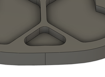

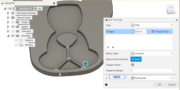

Since I knew I was going to be using a mill for the pockets and a water jet for the inlay I added a .05 radius on every corner. That way the water jet copper bits would fit without any hand work to adjust them. If I hadn't included that radius, then the copper would have had a sharp corner, but the milled brass part would not because of the round cutter used to mill it. The smaller tool, the closer to a sharp angle you can get, but then it's a trade off between geometry and time. 3/32 seemed small enough to me.

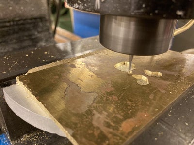

I've learned the hard way that fixturing thin material can be a pain in the butt. First off if you put it in a vice and clamp too hard it's likely to bend. Additionally, for this part, I wanted to cut a contour all the way around the piece. In the past I've either left tabs or left a thin layer of material all the way around and filed it off by hand. Both of those methods work, but for this project I wanted to try something new.

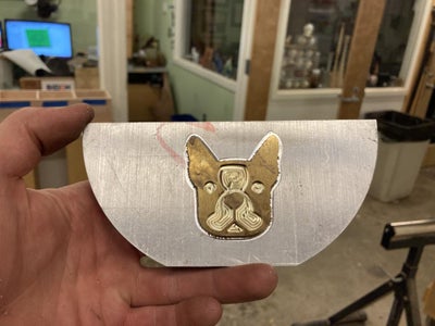

I'd heard of using super glue for fixturing, and figured that a good double stick tape could work just as well. I cleaned a scrap piece of 1/2 inch aluminum plate and the brass stock with acetone and then stuck the two together. The brass was slightly over sized, so I was able to use the offset edges to keep the work parallel in the vice.

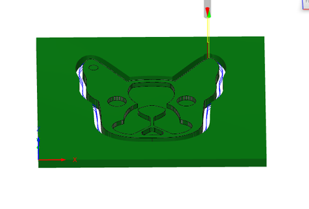

Using a 3/32 end mill at 6 in/min I was able to cut out the pockets and the contour of the dog face. On the first attempt, I used mist coolant, but that piece failed when the coolant dissolved the adhesive on my double stick tape.
My advice for tape fixturing is go slow, get really strong tape, and don't use coolant.

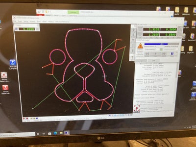

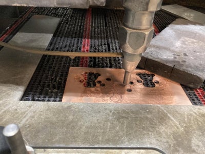

The copper bits for this piece were cut on the OMAX Micro Max water jet. Unlike most water jet machines, this one does not submerge the work in water before cutting, and uses plastic blocks instead of metal slats to rest parts on for cutting. The idea is that small parts don't get lost in the catchment tank. In reality, it works pretty well, but when the goal is a 3/16 inch dog snout, I lost a couple in the process. Aside from that, the only real issue I had was dialing in the offset to get a good fit with no gaps when I assembled the copper with the brass.

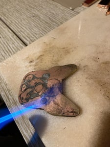

Anyway, back to the dog coin thing. Every good project has an ugly phase. This one is certainly no exception, and soldering is the ugly phase. I think I got the flux way too hot while trying to take photos and solder at the same time, but it still worked.

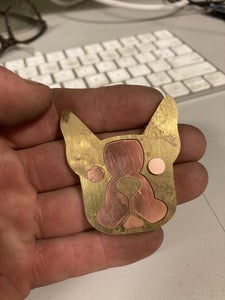

In order to get the best adhesion I could, I started by applying flux and a small amount of solder in each of the four pockets in the brass. I heated this and melted the solder to cover the whole bottom of the pockets first before placing the copper bits in at all. This was in hopes of getting full contact adhesion. After the pockets were fully covered, I heated the coin again and placed in the copper bits. Once in and hot, I used pliers to squeeze them into the bottom of the pockets. Some solder leaked out from the edges, which I think is actually ideal in terms of filling gaps.
