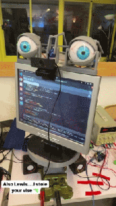

With ChatGPT, I can have an unconstrained conversation with a robot for hours at a level that easily passes the Turing test! It is quite a remarkable piece of technology that opens up many new doors...especially in robotics. In this Instructable, I will explore making an animatronic robot assistant that is powered with ChatGPT. The purpose of the robot is to create a more human UX for interfacing with ChatGPT. To achieve this goal, the robot will have a microphone/speaker system that enables a user to communicate entirely verbally. The robot will also have multiple anthropomorphic features like blinking/moving eyes and a mouth.
Achieved
The finished robot is a ROS-based device that runs off of opencv, assemblyai, pygame, and ofcourse ChatGPT. In additional to the original goal of having the robot blink/move its eyes, the robot can also rotate and physically track a user's face via a basic webcam. I am currently visiting Taiwan, so I have specifically programmed the robot to act as an interpreter between Anglophones (like me) and Sinophones. However, due to the ChatGPT platform, the robot can be relatively easily configured to perform other tasks. I have published all CAD/code for this project opensource in this Instructable so that other hackers can use this project as a launching point for building animatronic robots.
Code/CAD Repo: https://github.com/CallMeSwal/BotGPT

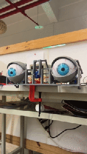

Step 3: Creating the Eye Mechanism
You speak with your eyes….or something cheesy like that! Whether or not the robot looks realistic is primarily dependent upon the eye mechanism. The specific eye mechanism I designed for this robot is a poor imitation of Will Cogley’s simplified eye mechanism. For those of you not aware, Will Cogley is the GOAT creator of hyperrealistic eye mechanisms. My project would not have been possible without all of the open-source work done by Will. In the subsequent steps, I am going to largely regurgitate Will’s process. However, since I am more artistically challenged than Will, I have made some slight modifications to his process that make it easier for non-art gods to follow.
Like Will’s design, my eye mechanism operates on the concept of having the X and Y movements completely independent from each other. Since my eye mechanism is almost three times the size of Will’s, I have added some bracing to make it more sturdy.

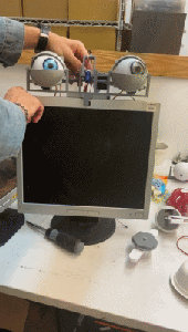

Step 11: Assembling Eye Mechanism
Print out the remaining eye mechanism components and then assemble the device as seen in the CAD files. The principle is that the lateral movement and horizontal movement servo motors are completely independent of each other. I noticed that the weight of my eyes could make my bracing sag. For this reason, I created a large amount of clearance between the eyelids and eyes.
Step 12: Mounting Eye Mechanism on Monitor
Next mount your eye mechanism on the computer monitor using the MONITOR_CONNECTOR component. For my robot, I am using an HP 1502 monitor because I found one of these lying around in my workshop. But any monitor would do the job. For this reason, I have attached the raw fusion files so you can edit the CAD as you see fit.
Step 13: Mounting Monitor on Turntable
I want the robot to have an immersive/interactive experience. So in addition to the moving eyes, I created a turntable for the monitor to “slowly” rotate upon. The turntable is driven by high torque stepper motor.
