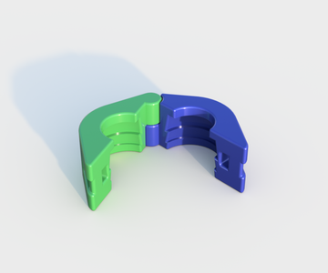

Step 1: Create Hasp Features
I’ve measured the hook part of the padlock, so now I need to draw the profile of the hasp so I can create that feature.
Create a Sketch on the Mid-Plane for the Lock
I create a sketch in the mid-plane and draw circles that represent the inside and outside diameters of the loop at the end of the padlock hook.
I draw lines that represent the straight cut at the back of the hasp, then offset the circles by .5mm so that the lock can easily slide in and out of the hasp.
Extrude the Sketch (Direction: Symmetric) to Cut Out the Shape
With the profile finished, I extrude it to create the hasp cuts in both halves of the bottle lock. I hit the down arrow when I hover over the part I want to extrude until the profile is highlighted. I extrude the profile using the diameter of the padlock hook and add .25mm (remember the tolerance we decided on in the Fit Tests lesson?), giving me a cutout with a little play when I use the symmetric direction.
Offset the Hinge Arc on the Two Parts for a .25mm Clearance
Extrude the Profile for Clearance (Top)
Extrude the Profile for Clearance (Bottom)
Next, I need to create a small gap between the hinge parts on each of the clamp halves. I create profiles on the top and bottom faces, then offset the inside arc by .25mm, then extrude this new profile to the midpoint of the model.

If you want to see the extent of your part movements in Fusion, you can use Contact Sets. I go to Assemble > Enable All Contact. This will keep your components from crossing into each other when they move.
With All Contact enabled, I can see that my lock will stop at 174º at its widest point. This becomes very useful when assemblies are more complex.
When assemblies have multiple parts, it’s also a good idea to change their appearance so you can distinguish between parts. I right click and select Appearance from the popup menu, then just click and drag the material swatches onto my components.
